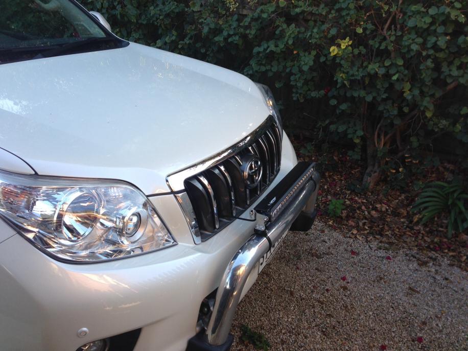

              Hi peter-mcc, I have just fitted a Lightforce LED lightbar to my 2012 Altitude on the OEM nudge bar. Few local Prados with the nudge bar have standard round spotties but I didn't like the appearance. Plus they have had to get brackets welded to the nudge bar to fit the spotties due to their weight (3kg each compared to 1.2kg for the Lightforce light bar).
              Lightforce also have a light switch specifically designed for the 150 Prado blanks (sorry Amts, didn't know this when I contacted you but will be in touch for other stuff).
              I preferred look of Oem bar as it is 75mm whereas most after market nudge bars are only 50mm. Haven't seen anybody with lightbar on Oem nudge bar before, but I am very happy with mine.
              BTW, the Lightforce 20 inch combo light bar is brilliant, literally. I know you can get Chinese made light bars pretty cheap but being a parochial South Aussie, I wanted to buy off the local Lightforce guys.
