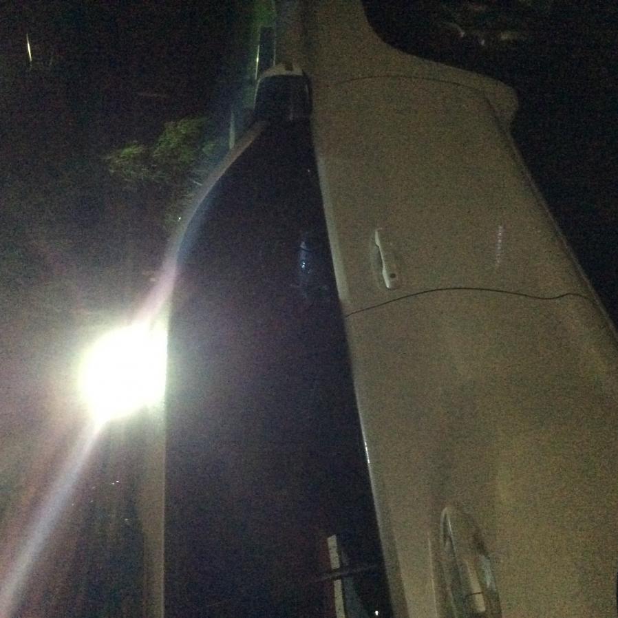

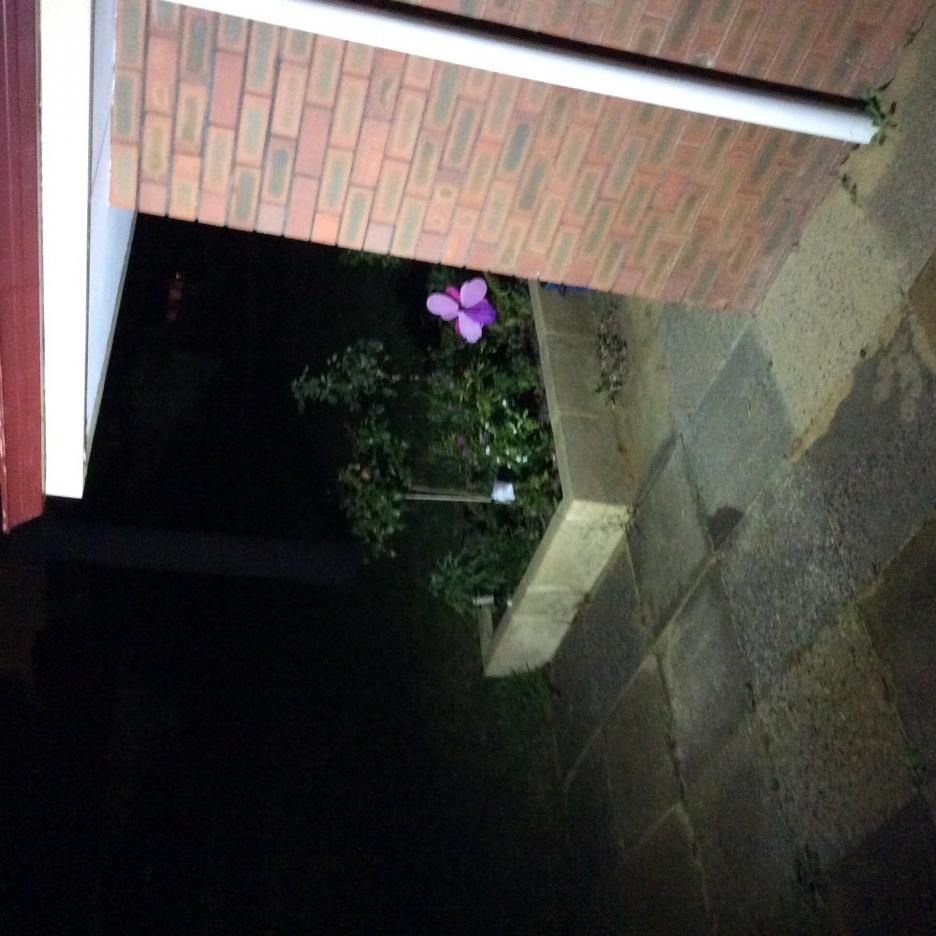

        Pics of them working
        Geoff
