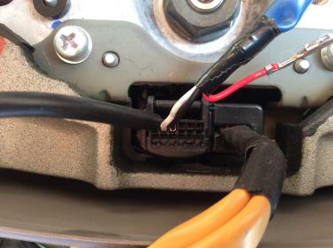

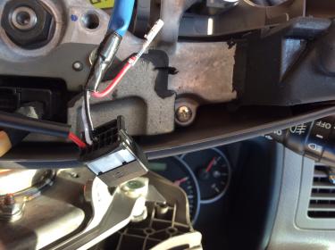

            Here it is, one end goes into the stalk and the three wires go into the steering wheel! But in what order? Slot one is occupied by a red ground wire going to the airbag.

              Hey,
              I have not seen a cruise control harness with x3 wires before, and as I have only worked on 120 series, I'm wondering if this is what the 150 version looks like?
              All I can tell you is which wire goes where based on what I have worked with on the 120. It may be that the red wire is superfluous and not needed on the 120.
              I can't see from your image where the wires go into the white connector, but this is what they look like on the 120;
              The black wire is on the right of the connector, and it goes to pin 4, white to pin 5, and horn through pin 6, as in this image;
              As I'm not sure what the 150 version of the cruise stalk and harness looks like, and also unsure if you're working on a 120 or 150, all I can suggest at the moment is reproducing what is in the photos above.

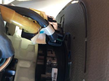

                      Ok, here are the photos, connected white and black next to the red ground that goes to the airbag, nothing took off the steering wheel column shroud, there are four cables going into the connector below the clock spring, they were blue, yello, white, and a green going into the last pin slot on the lower left side. I do not have stereo controls. I can switch the wires or put in all three, but the green wire below threw me off. What is the best way for pulling the wires out of the pins without destroying the metal piece, there is hardly any room in their. Suggestions? Which wire into which slots, I am so close I can taste it, at least I hope I am!

                        Hey,
                        Sounds like you need to do a continuity test between the j45 connector underneath (next to the yellow airbag connector) and the connector on the clock spring. Just check pin by pin and make sure you are getting a signal through the clock spring on each pin. The clock spring internal ribbon is easily broken, so good to double check each pin is active.
                        I'm not sure what that green wire is from!?
                        There is unfortunately no easy way to get those pins in and out.
