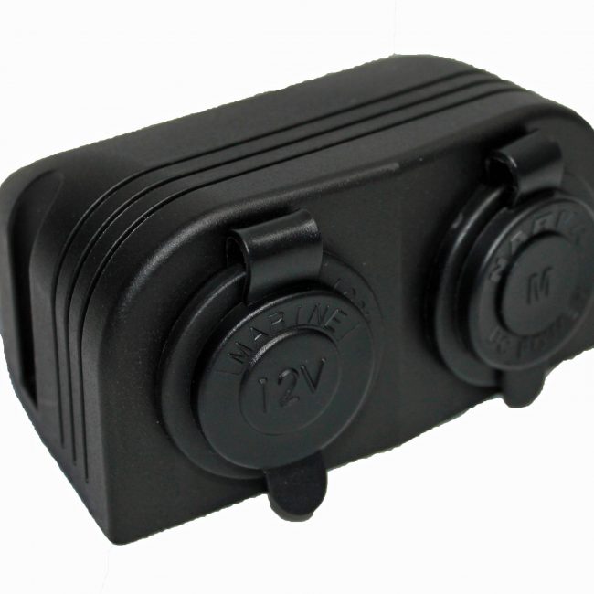

  • I ran mine down the drivers side and put the CIG/Merit in one of these:
    Mine sits on top of the Drivers side wheel arch/arm rest as I couldn't bring myself to drill huge holes in the trim!
    The other reason I went down drivers side it that the AUX is on that side and I could just run it straight down the body cavity.
    Micheal.

      Thanks for the response. Yeah I was thinking the same thing. Not sure I want to drill big holes in my new car.

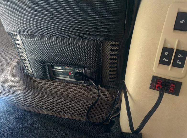

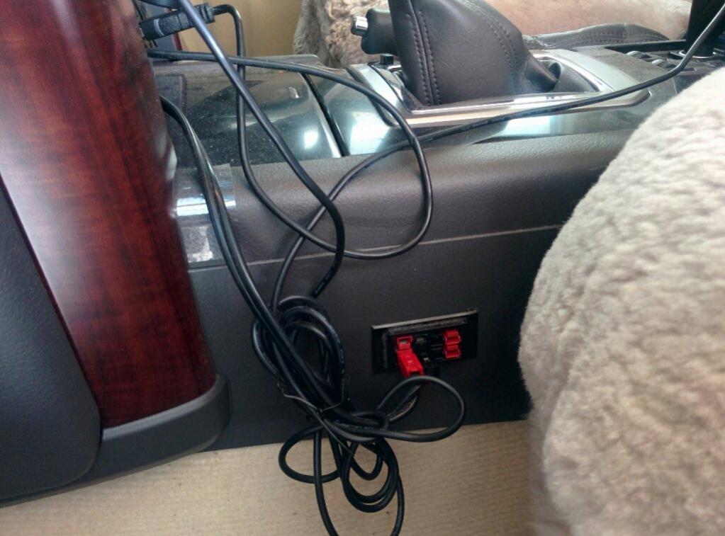

      • I went with Anderson Powerpoles. Gives me 4 outlets in the back, and 4 up front, all in a nice small form-factor.
        • Hi dCB, I'm a big fan of the 30 amp power poles and have fitted to all my batteries, meters and test equipment, but we use to use and supply them in the 2 way and 4 way panel mounts but the small 30 amp power poles only have to be bumped and they snap off very easily.

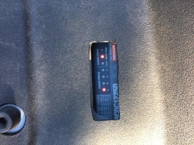

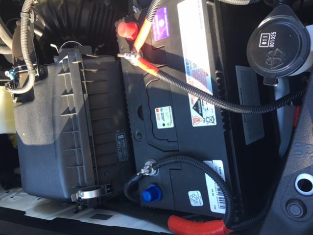

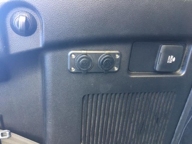

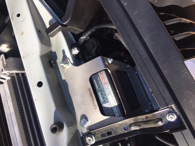

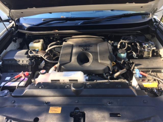

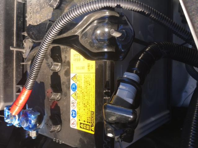

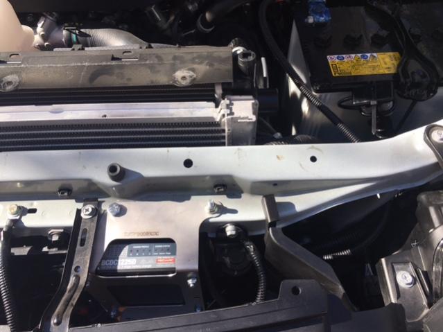

          • Hi Everyone,
            Here is my Dual Battery installation;
            - Redarc BCDC 1225D ($415) held in position by an Out of Town 4WD SS bracket ($55) and protected by Redarc FK40 40A Midi Fuses ($60)
            - Century/Yuasa 95Ah Deep Cycle Maintenance Free Battery ($280) with Piranha battery tray ($195) (not shown yet in photos)
            - 8B&S cable between main battery, BCDC and Aux Battery ($20)
            - 8B&S twin core cable run to rear ($40) of vehicle protected by 30A inline Maxi fuse ($15).
            - 2 x 12V sockets in rear cargo area ($30), each protected by individual 10A inline fuses ($10);
            - All cable joints & lugs were crimped, soldered, covered in heat shrink and put inside split wiring loom. (~$60)
            Total spend (excluding own time of approximately 5 hours) approx. $$1,180.00
            Not cheap but I am very happy with the job and looks very professional.... even if I so say myself..... Local installers in Sydney (auto-electricians, ARB, etc.) quoted me over $2k to suppyl and fit this system.
            Sorry I didn't take any photos during the installation. I was too focused just getting the job done.
Name:	Cutout for Redarc Display.jpg
Name:	Main Battery with Soalr input Anderson Plug.jpg
Name:	Out of Town 4WD bracket with Redarc_1.jpg

Name:	Out of Town 4WD bracket with Redarc_2.jpg
Name:	Rear 12V sockets.jpg

                Very nice,
                I did similar with my 1240 but got tin(from pp) to make ss bracket side ways to see lights through front grill.
                Arb colour code deluxe bar, safari snorkel, lightforce venom HID's, GME uhf remote face, redarc tow pro, redarc bcdc 1240, pioneer platform, 40" curved light bar, dual battery, 3" SS exhaust, EGR mod, trans cooler upgrade, provent catch can, scangauge 2, diesel care secondary fuel filter, Tin's bash plates and actuator gaurd, 2in Bilstien and kings lift,
