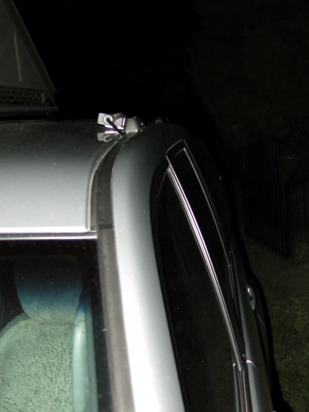

                    I pushed my twin B&S cable under lip of the windscreen seal edge, see pic. Goes to LH front roof rack leg mounted Weatherproof Anderson plug - plug cap faces rear. AFAIK 15A cable.

                      Thanks for the pic brundah01. Any chance you (or anyone else who's done this) can post a pic showing the cable under the lip ? IE, from the left hand side of that photo you posted ?
                        Drivers side on my 120 Prado.... You can see the twin tucked neatly under the trim.
                          Thanks Craig ! any glue/silicon/silastic used to hold it in there ?
                            Although it sits so snug it doesn't really need it, I did put a few dabs of black silicone in the channel first just in case the sheer power and speed of the V6 caused the cable to fly out...
