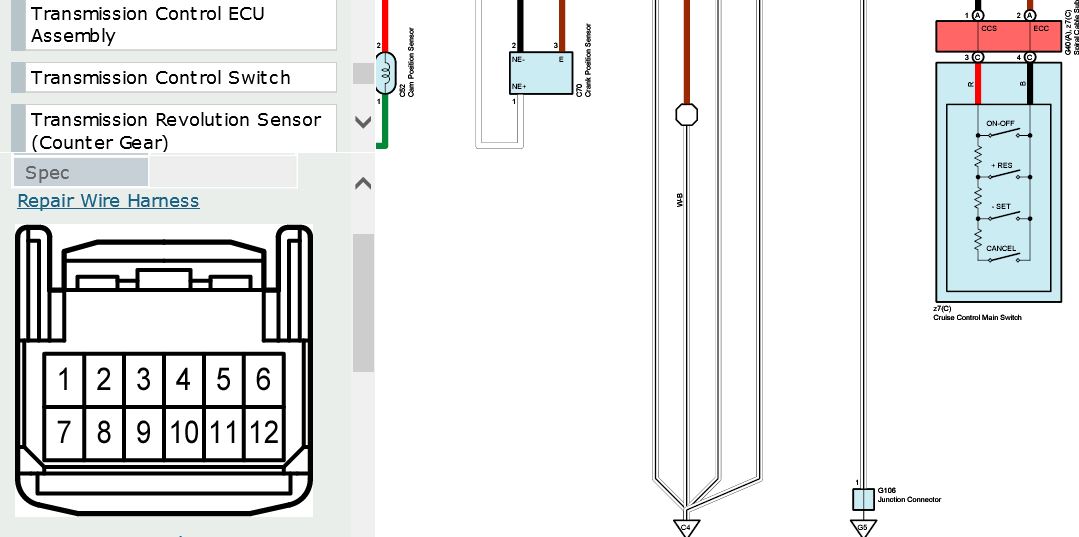

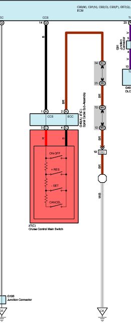

    I'll attach a pic of the wiring (for educational purposes) for the column stick to the main ECM.

              Meh. Doing it again. Will disassemble & test. Thanks Macro for the schematic.

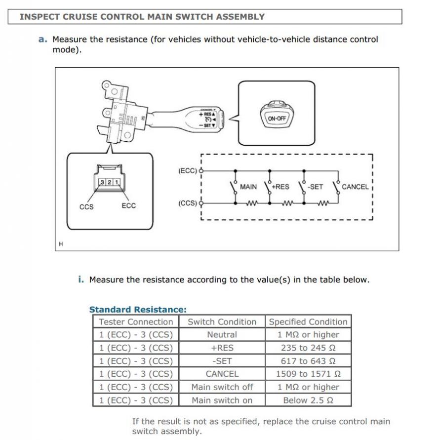

                    Here's a little doc of the resistance values to expect at the switch though the issue is in the spiral cable further downstream by the looks. At least this gives you an idea of the values to expect when pushing the various buttons. The off/on button is a dead short and the others buttons are specific resistance that the ECM can decode.
                    The clockspring/spriral cable has a 12 pin connector under the dash somewhere where all the steering wheel controls come out (from the clockspring cable) so you can break that connector and do the measurements there with a multimeter if you have one. Looks like the cruise controls use pin 1 and 2. Looks for the black and brown wire next to each other.

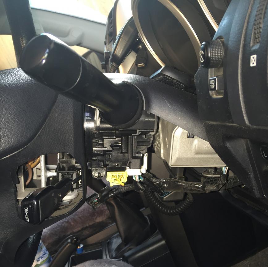

                        OK pulled it apart and confirmed our suspicions. Switchgear returns resistances as per Macro's schematic. Clock spring has dropped 1 wire so will go shopping to see how much that's gonna cost... [insert scared face here]

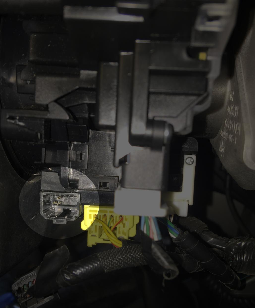

                        I pulled the steering wheel off, but then discovered you can test this end of the magic by removing the lower steering column cover and sticking a meter onto the 2 bottom pins in the connector circled in the below diagram. If this doesn't return Macros' resistances then you need to pull the wheel off to determine whether its the switch or the clock spring wire.
