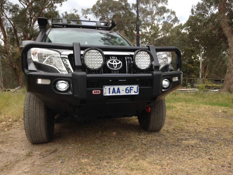

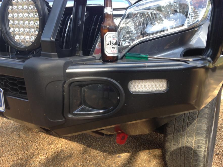

    Just thought I would share my latest mod on my 150.
    When I purchased my ARB summit bar I told them not to include the crappy fog lights that they charge a fortune for, as I knew Stedi had plans for a sweet LED version in the pipeline.

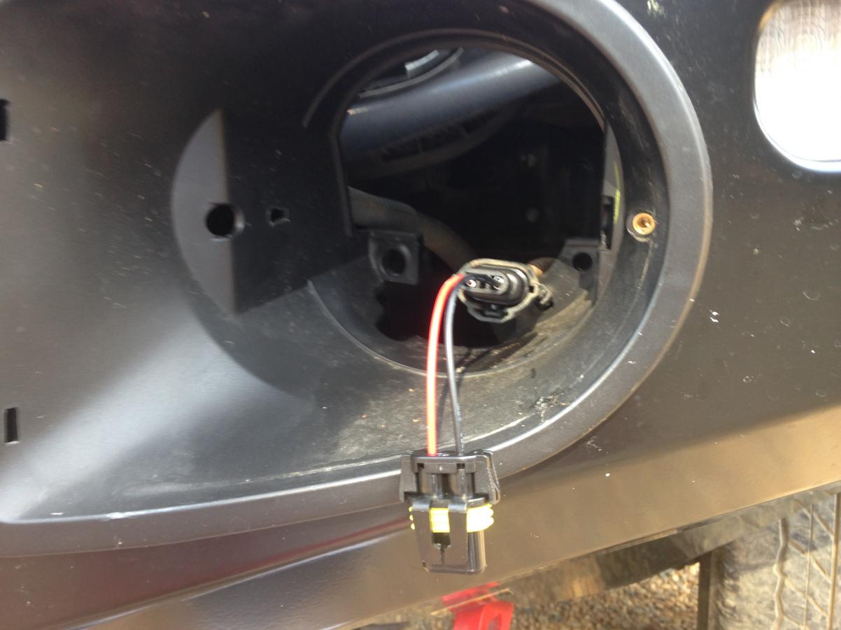

    I pre-ordered them a month ago and waited patiently for delivery. They arrived yesterday and I am pretty happy with the result. Having said that I was a little disappointed with one of the connectors that come with the kit. Took quite a while to work out
    what I was doing wrong (or what was wrong with the connector). Turns out the plastic housing connects just fine but the pins/terminals inside the plastic were not mating properly. Had to coax them in to make them work.

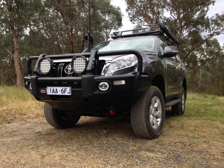

    Still, now that all is done, I'm stoked with the look and performance. The halo DRL is sweet and overall they are so much better than the stock ARB fogs.

      Took about 10 minutes for me to piece the puzzle together (one screw, a spring and a plastic lug). It all made sense once I fitted them to the vehicle. As stated in my post above, the real issue was the "pigtail' connectors
      between the prado wiring loom and fog light not being the best quality. Again, after a bit of problem solving, I worked out that I had to press the male pins from behind to locate them properly.

              I had exactly the same problem as juz with the supplied connectors to the Toyota fog light connectors not making contact because the pins were not long enough. I also managed to push them through a bit from the cable side to make contact but I'm not confident they will stay that way so I am looking at changing the connectors to some better quality ones.
                Might give them some feedback. Stedi really should send out a quality solution to all those that have purchased these fog lights. They have pretty good customer service and listen to their customers. Hopefully they'll come to the party.

                              I also suffered from poor connectors which were broken, did not fit and did not make electrical contact.
