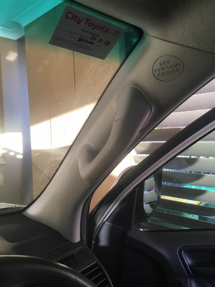

    Has anyone installed twin gauges into their Prado 150?
    I would like to install a volt and exhaust gas temperature gauges someone visible and not interfering with the air bag system. Click image for larger version

    Hi Halsey
    I think your pillar pic answers the question with the srs airbag sign on it.
    this would likely compromise the airbag deployment me thinks.
    Tony
      That was my exact thoughts too.
      Was just putting it out there in case someone has found a work around.
      You would not want a couple of gauges coming towards your face at 100mph if the airbag was deployed in an accident.

        those pods are fine to install , and will not interfere with the airbags in any way. if you remove the A pillar trim you will see that the very end of the airbag stops at the top of the pillar , so anything below the grab handle is well clear.
