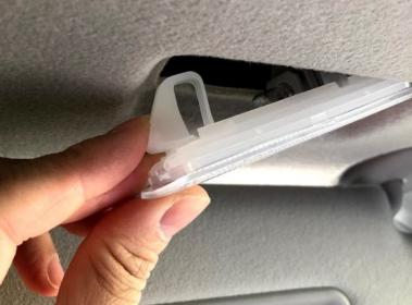

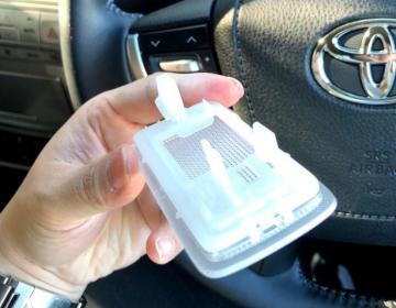

      I finally figured out how to remove the cover. It's quite simple actually. There is a retainer clip on the left hand side of the Driver's Side one, and on the right hand side of the front passenger's one. Use a flat tool to depress that retainer clip and it should be able to release the entire unit from the ceiling (not just the cover). Then, you can carefully pull the uni out, and remove the cover to get to the bulb.
      Photo of retainer clip:

      The light unit (with the cover attached):

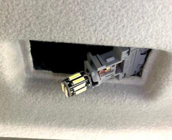

      T10 Wedge LED:
