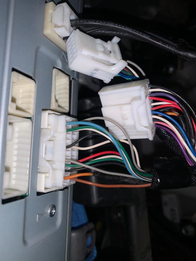

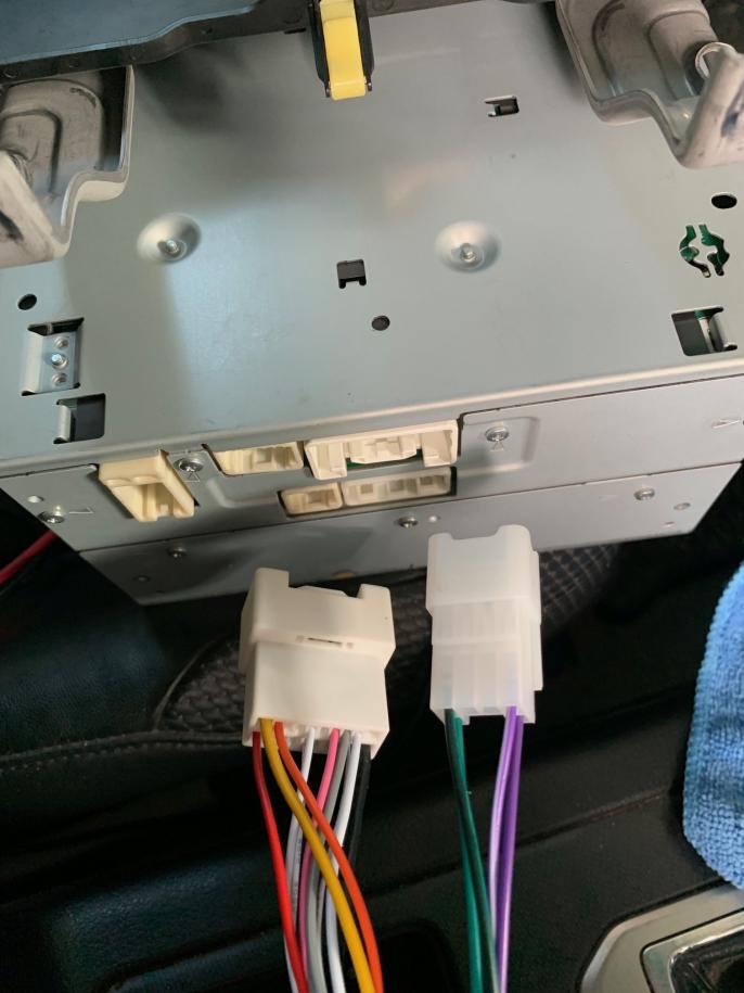

- Took a few hours and reasonably straightforward if you're comfortable pulling your dash apart (taking the centre-stack equipment out). Most of the cables are just piggyback (unplug the original, plug in the new cable and plug the original cable into a female plug on the new cable). The touch-cable required access to the circuit board, but it was still a relatively simple process of disconnecting a ribbon cable and connecting a new one. Reasonably good instructions were provided.
- Naviplus did a good job of pre-configuring the unit and marking any unneeded sockets.
