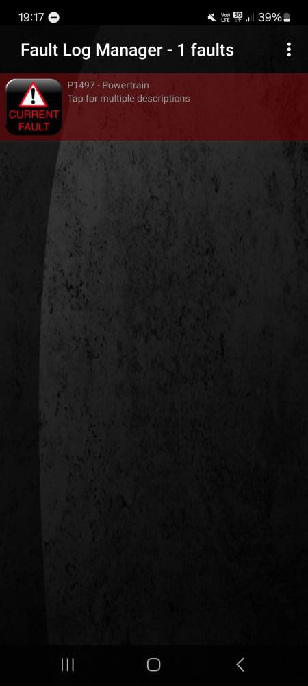

    2012 Diesel auto 150 Prado (360,000kms) Full story - I completed a camshaft reseal and water pump replacement and pressure washed some of the grime out from under the bonnet. Test drove the car with no problems. Trouble has started since I replaced the original battery terminals. Dash 4 LO and traction control lights are flashing. Check OBD and active code P1497; I tried to clear it with no luck (worth a shot, it being a battery-related issue). 4 LO has not been engaged , nor traction control switched off, Car will not go into overdrive and warning lights stay on. I started checking plugs for water ingress, but nothing was found troubling as yet.

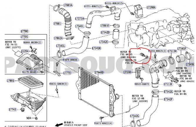

    Did you get that issue sorted as code actually related to the Intake Air Temp Sensor 1 (Turbo side of the intercooler) being high (which means it is open circuit).
    P1497 - Intake Air Temperature Sensor 1 Circuit High
    Open in the intake air temperature sensor (turbo) circuit for 0.5 seconds (1 trip detection logic).
    • Open in intake air temperature sensor (turbo) circuit
    • Intake air temperature sensor (turbo)
    • ECM
    Sensor P/No should be 89424-60010 if its not a wiring/connector issue.
Name:	intake air temp sensor.jpg
