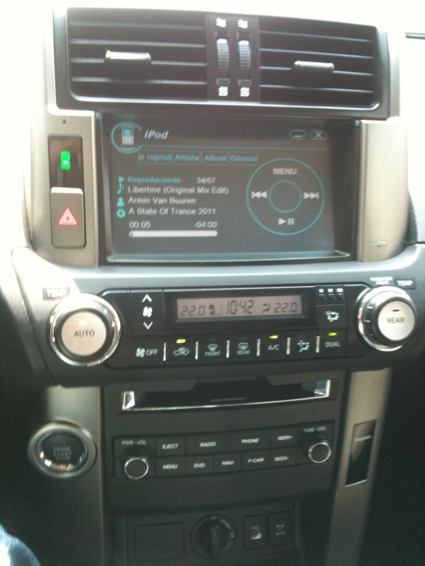

                        Smoov, T6813G Dvd player of Tradesolution.hk is ok, it have an 45x4 amp built in, I tested it and works fine in my LC150TX ... thanks God!!!
                        Tomorrow Im gonna install myself the unit and share some pics....
                        Ricardo
                        • #57
                          Hi Frankl, no Im from Lima Peru-South America, here in Peru we have LC150 VX and TX models 2.7 4 cyl and 4.0 V6 I think TX model is the same as GX in Australia... I finish installing my radio and it works fine...
                          The only thing is that I dont know how to disable the funtion on DVD "enjoy music while driving" when I am not driving!!! I do several things with the monitor pen, and sometimes works de video...but most not...do anyone have this issue and know how to disable this security aplication??
                          Thanks, and sorry for my bad English... Im trying to do my best...and this forum helps me a lot!!!
                          cya..
                          • #58
                            Very easy, at the rear of the player there is a green wire with a label on it saying BRAKE. Connect this wire to permanent earth, the player then thinks you have the hand brake on and will play the video.

                              • #60
                                Problem solved, thank you Smoov!!!!
