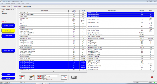

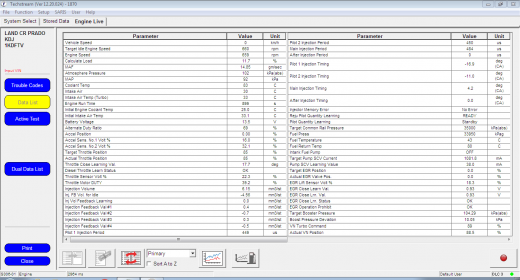

                            Hey guys just took the readings on mine yesterday. All looks well but thought I had best check I am not missing something.
                            - 150 GX 2012
                            - 150,000kms (which is why I thought I had better test)
                            1) Feedback VOL looks high both cold and warm
                            2) Injector #1 looks like its running low
                            Anything else I should be looking for?
