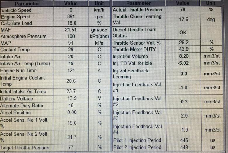

I've started noticing a rattle/knock from my 3.0 D4D when at low-ish RPM - Above idle, but before 2.5k RPM. It only seems to be present when the motor is cold - not necessarily winter cold, just "not run in a few hours" cold. I had a chat with a mate of mine and the dreaded "I" word came up... I have 106k km up on the ODO and the last service was 6,000km ago.
Should I be worried?
