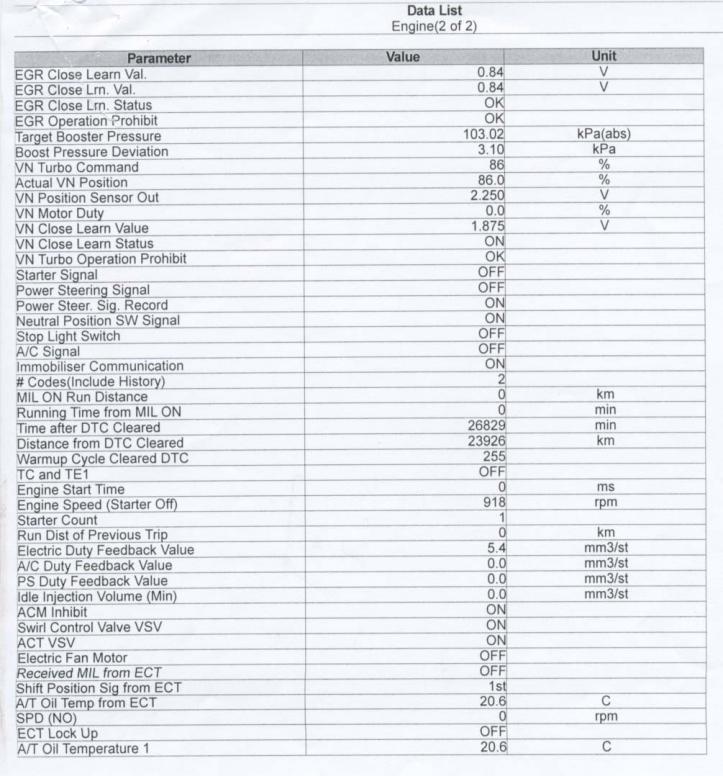

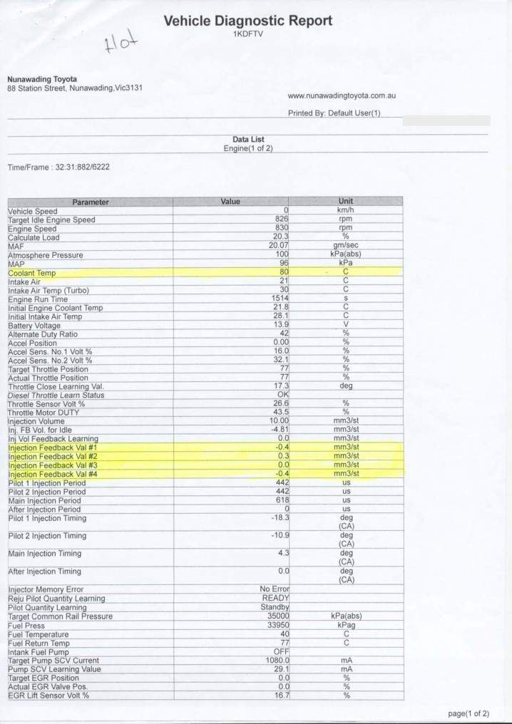

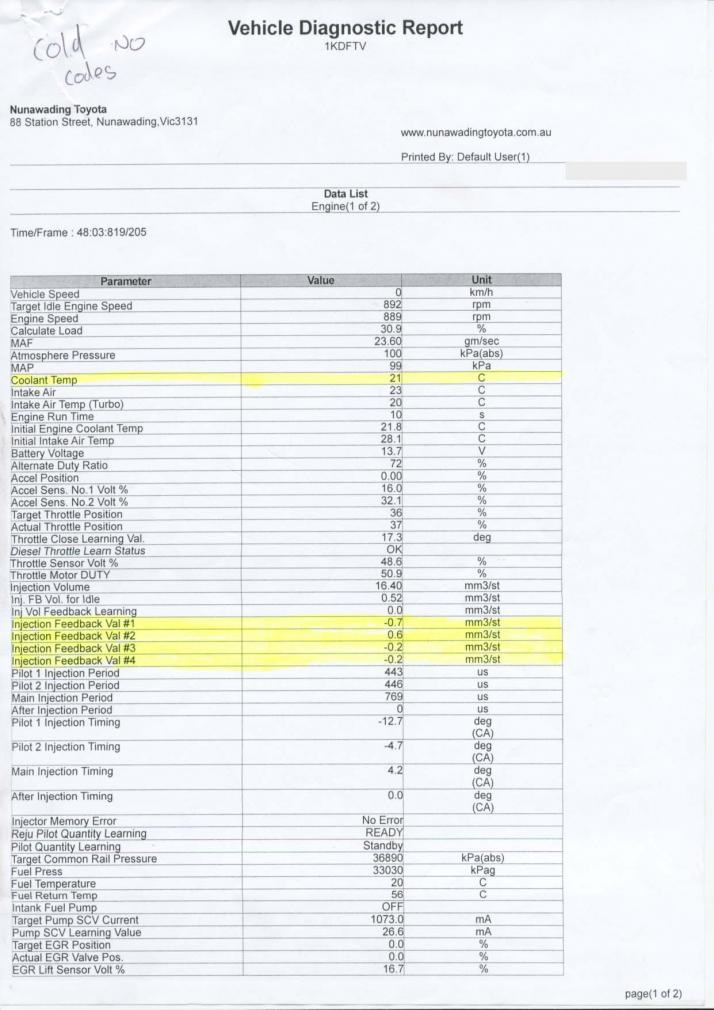

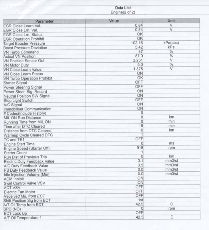

    I recently had a service done and asked for a printout of the Diagnostics cold and hot. From what I have read the values are OK except maybe the calculated load. I am suffering data overload so would appreciate informed comments.
    Vehicle history:
    2012 Altitude Auto D4D 50000km
    BP Ultimate Diesel exclusively for last 15000km
    Catch can and blank plate fitted about 10000km ago.
    Towing - 2000km to Flinders Ranges with 1000kg of camper trailer. Regular towing of a small trailer approx 200kg.
    (Otherwise a bit around town but mostly highway and some high country.)

    Your right the load is high & out of spec.
    The volume is also high.
    I'd guess the air con was on. If not you have a problem.
