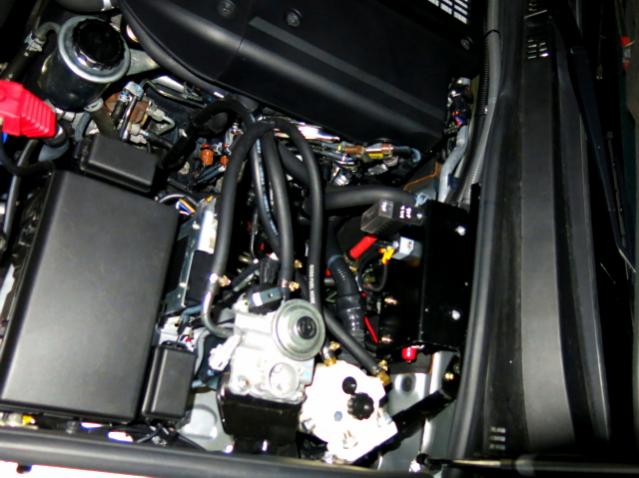

I'm one of the minority who have fitted a Racor 230R2 (2 micron) as a Final filter. Because some suspended water and fine particle contaminants can pass through the TMC filter media - both can cause erosion in the D4D injectors.
Sure there is a slight risk of increased flow resistance (if the Final filter becomes partial clogged) & then TMC filter protection warning won't detect this. BUT with good maintenance practices this is highly unlikely with the Racor very high flow rate & capacity filter. Regular filter draining / change practices / only BP or Caltex Premium Diesel from high volume outlets & I see this configuration as best option.
Note hose config allows easy lift out of either filter.

As an aside rusty62 your picture a few posts back shows what looks like codan non fuel injection hose used, maybe I am wrong and it is injection fuel hose as i was told the ordinary h511 hose cannot handle the CRD pressure.
As an aside rusty62 your picture a few posts back shows what looks like codan non fuel injection hose used, maybe I am wrong and it is injection fuel hose as i was told the ordinary h511 hose cannot handle the CRD pressure.[/QUOTE]
These lines are on the suction side of your pump. No pressure.
