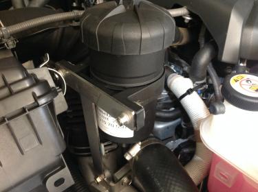

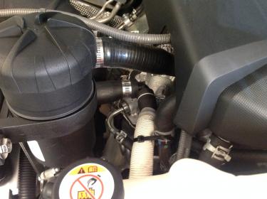

    I have recently had a ProVent Catch Can fitted to my 2018 Prado.
    I am not sure if was installed correctly - hence the picture.
    I also cannot be sure that the vibration coming from the engine/airbox/lines are causing a "growling" sound around 1000-1100RPM. It seems like a resonant vibration and I am thinking it could be from the Catch Can install. It is hard to narrow down where this vibration/hum is coming from. Ive had the Can fitted since 50km so I don't have anything to compare it to pre/post install.

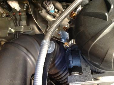

    As you can see, the outlet/inlet for the catch can runs in between the airbox hose....
    Without seeing the 2018 Provent install instructions - does this look correct?
    It seems quite tight in there to possibly install another way without kinking the block exhaust hoses etc.
    Thoughts/comments/suggestions
    It looks correct.

              Photo would be exactly the same as post 1 above.
