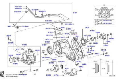

    Im after some help identifying the part number for the seals and nut on a 2014 150 prado
    got a oil leak from rear output flange on my transfer case
    I believe there is an inner seal an outer seal and a nut ??

    33309b 33309-35112 flange sub-assy, output shaft companion , pnc 36111b=type
    b
    grj150,kdj150,lj150,trj15#
    33309c 33309-35120 flange sub-assy, output shaft companion grj150,kdj150,lj150,trj15#
    33309d 90312-23001 seal, oil(for transfer output shaft companion flange) grj150,kdj150,lj150,trj15#
    33309h 36275-35030 washer, transfer output shaft , n=31,od=38 grj150,kdj150,lj150,trj15#
    33449d 33449-32020 magnet (for transfer case) grj150,kdj150,lj150,trj15#
    35015f 90521-72001 ring, hole snap(for transfer adapter) grj150,kdj150,trj15#..atm
    35015g 35015-35120 adapter, transfer, rear kdj150..5fc
    35015h 90250-11003 pin, ring(for transfer case) grj150,kdj150,trj15#..atm
    35015j 90311-43007 seal, oil(for transfer case adapter rear) grj150,kdj150,trj15#..atm
    35015w 90301-15004 ring, o(for transmission case adapter refill plug) grj150,kdj150..5fc
    35015x 90341-18059 plug, refill(for transmission case adapter) grj150,kdj150..5fc
    35157b 35157-60010 receiver, transfer case rear adapter oil grj150,kdj150,trj15#..atm
    36102 36102-35040 cover sub-assy, transfer case grj150,kdj150,lj150,trj15#
    36102d 36102-35060 retainer sub-assy, transfer rh bearing grj150,kdj150,lj150,trj15#..4fc,5f,5fc
    36102f 90311-43008 seal, oil, no.2 (for transfer rh bearing retainer) grj150,kdj150,lj150,trj15#
    36103a 90119-08a28 bolt (for transfer case) , *8-1.25px55-30 grj150,kdj150,lj150,trj15#
    36103c 36103-35070 case, transfer, front grj150,kdj150,lj150,trj15#
    36104d 90179-22016 nut (for transfer output shaft) grj150,kdj150,lj150,trj15#
    36111a 90501-20091 spring, compression (for transfer case) grj150,kdj150,lj150,trj15#
    36111b 90311-41017 seal, oil (for transfer case) , type b:refer illust. grj150,kdj150,lj150,trj15#
    36111c 90341-14012 plug (for transfer case) grj150,kdj150,lj150,trj15#
    36111g 90250-10214 pin, straight (for transfer case) , l=14,od=10 grj150,kdj150,lj150,trj15#
    36111t 90441-05001 tube (for transfer case) grj150,kdj150,lj150,trj15#
    36112 36112-35090 case, transfer, rear grj150,kdj150,lj150,trj15#
    36114b 90341-18006 plug, no.1 (for transfer case) grj150,kdj150,lj150,trj15#
    36114c 90430-18008 gasket, no.1 (for transfer case) grj150,kdj150,lj150,trj15#
    36115 36105-35050 housing, transfer extension grj150,kdj150,lj150,trj15#
    36115c 90311-41007 seal, type t oil (for transfer extension housing) grj150,kdj150,lj150,trj15#
    36117l 90441-05001 tube(for transfer adapter) grj150,kdj150,lj150,trj15#
    36128 36128-35060 deflector, breather oil grj150,kdj150,lj150,trj15#
    36179 36179-60030 protector, transfer case lower grj150,kdj150,lj150,trj15#
    36179a 91611-g0820 bolt (for transfer case lower protector) grj150,kdj150,lj150,trj15#
    36407 36407-60250 hose sub-assy, transfer breather kdj150..5fc
    36478 36478-60080 bracket, transfer breather kdj150..5fc
    99999 90119-08336 bolt
    99999 90119-08a29 bolt, w/washer
    99999 90119-10369 bolt
    99999 90119-10370 bolt
    99999 90241-07003 pin, w/head
    99999 90387-31002 collar
    99999 90464-00074 clamp
    99999 90464-00082 clamp
    99999 90929-01447 clamp
    99999 90930-03207 plug sub-assy,
    99999 91511-60612 bolt
    99999 91611-60822 bolt,w/washer
