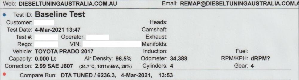

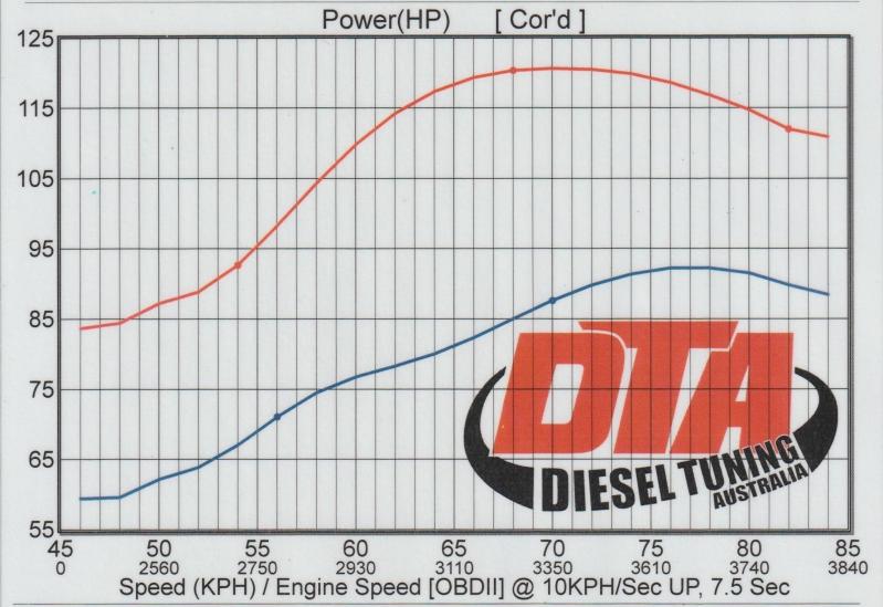

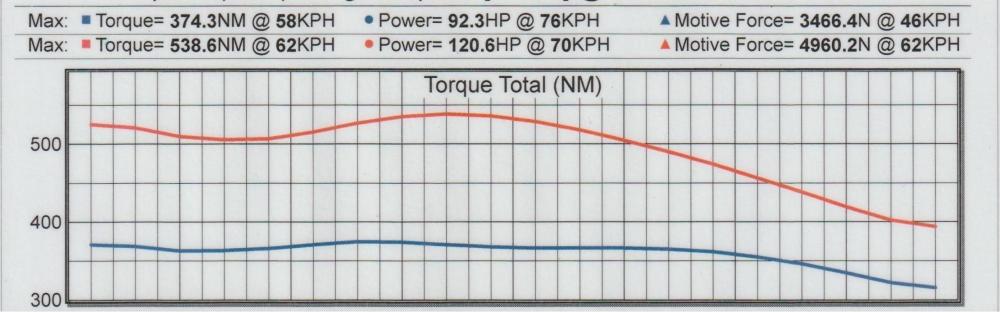

    Thought some might be interested in results of a remap on the 1GD.
    I have never been impressed by the amount of squirt from day 1 & tuner commented it wasn't developing the power it should have.

    Big difference - 5th & 6th gears now seem useful.
    Biggest surprise is 2-3L/100kms better fuel consumption - wasn't expecting that. (thought it marketing )
    Very impressive gains.
