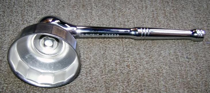

    6. Remove the filter housing with a filter wrench attached to a 3/8-inch socket wrench. Turn in a counterclockwise direction.Click image for larger version

    10. Insert the filter housing back into the cavity and tighten it with a filter wrench in a clockwise direction. Torque to 25Nm.
