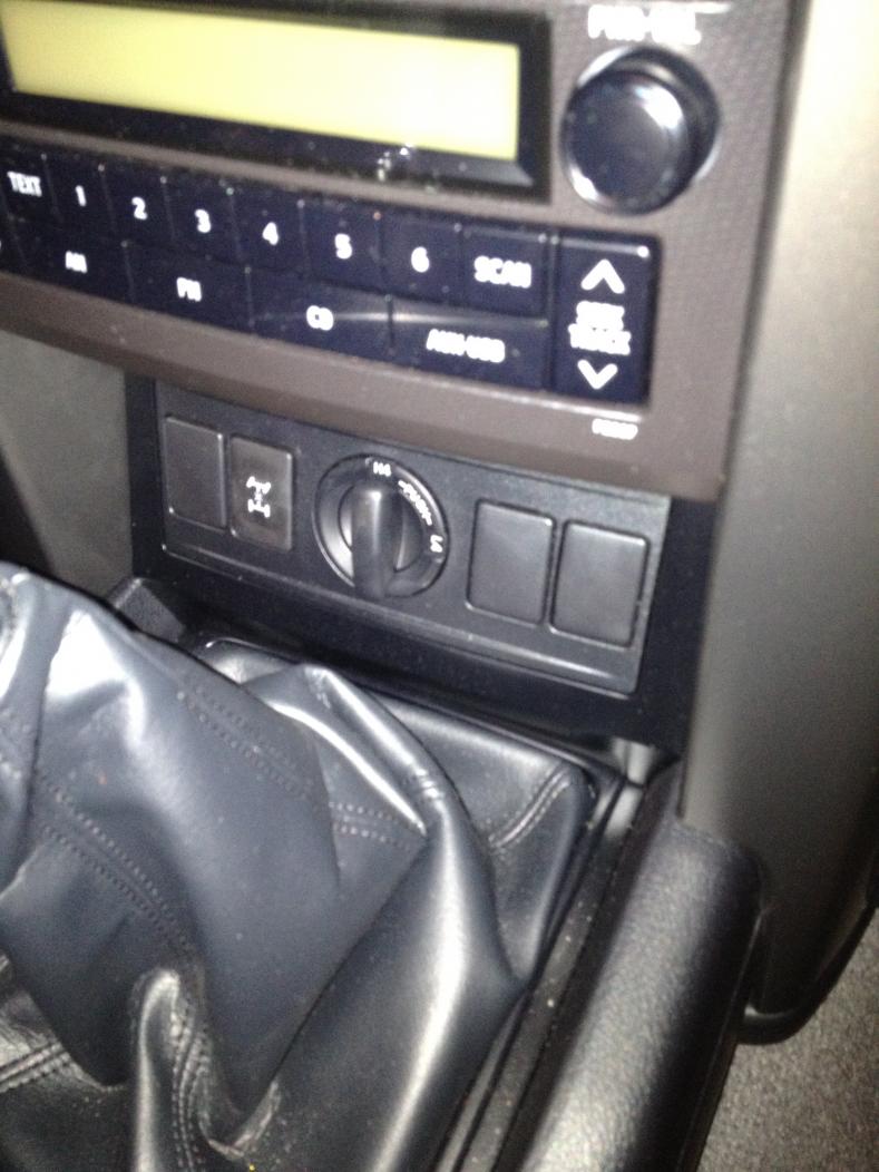

    hi
    not a big fan on pulling panels off and havnt pulled many off in the prado
    how to i pull the panel off with the low range selector switch to access behind it
    hey mate the two silver columns either side just pull off, and then i think theres a screw or something behind.

      Easy as.. Jut as Ages said. Rip off the silver panels, pop out the screws and it will come straight out.

        how do i pull out the silver panels
          Grab them from the bottom, ya thumb on one side and a finger on th other. Pull it out and slightly up, pull it from the bottom, closer to the floor..

            thanks for your help
              Pull the heater controls out first, then the silver panels.
              The 4wd Lo selector panel just pulls out too.
              You can do the whole lot about 30 seconds.
              No need to undo any screws at all..
                What model is that panel from? My TD auto GXL has a "big" switch on the right hand side (that is basically the 2 separate ones joined), but 2 extra normal sized switch holes would be much more use full...
                Edit: I noticed yours is a manual...
                  2012 gxl manual

                    It's a GX thing I believe?
                    *edit* It can't be as it has the radio down there, must be a manual thing...
