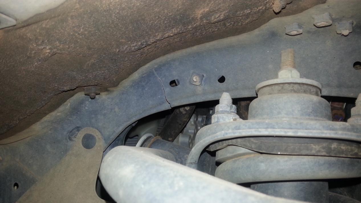

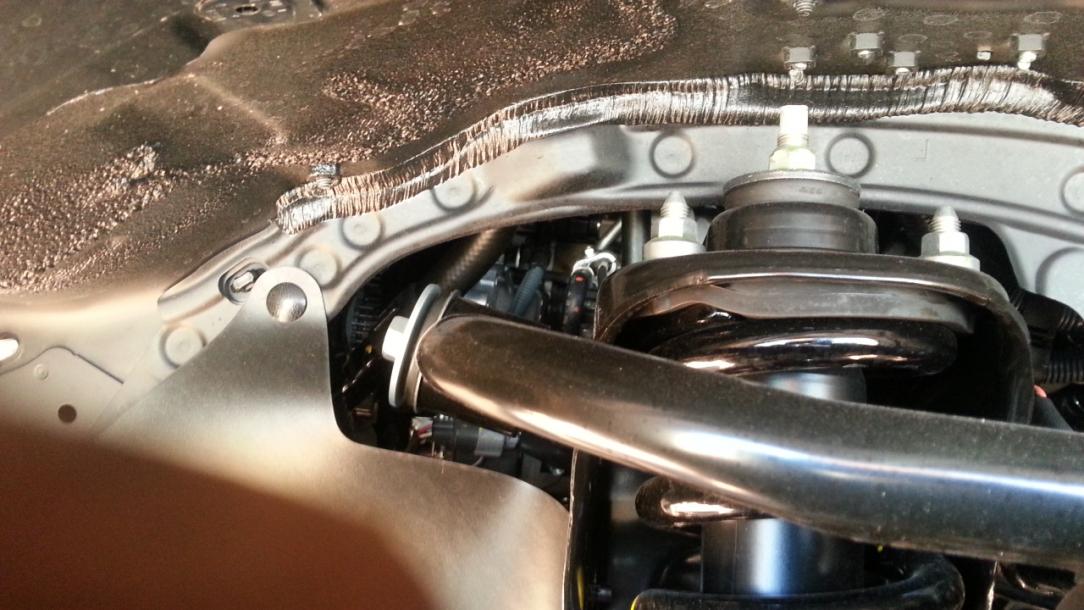

            Finally had time to have a look at the new guard design, picture attached below. Also included a picture of an old style cracked guard.
            I now understand why the cracking has been occurring and what Toyota have done to address the problem. My mechanical engineering design theory is pretty rusty but I'll try to give a brief explanation.
            If you look under the guard you will see that the body, of which the guard is a part, is supported by a rubber mount at the front of the guard next to the radiator. The other mount is at the back of the guard just below the front door hinges. This in effect turns the guard into a 'bridge' and the battery creates a point load on the bridge (guard).
            I have attached a diagram that shows what this looks like in terms of force and bending moment. The bottom diagram is the bending moment graph for the bridge, the one above it is the shear force graph.
            The failure point on the guard is in tension and more than likely close to the point of greatest bending moment. The design of the bridge (guard) is not a problem in day to day driving but on corrugations or with sudden loads due to hitting bumps etc the force exceeds the capacity of the thin tensile section of guard causing it to fail. Microscopic examination would probably show some necking (thinning) around the crack, which precedes failure in this type of event.
            The new guard solves this problem by changing the shape of the area under the greatest load, the bottom of the guard, and by providing double the strength in the high load area through the using of a spot/thermal welded backing strip.
            Hopefully I haven't broken any rules by posting this here and in the cracked guard thread.
            [B]Steve[/B]

                  • Originally posted by krypto View Post

                        • Can some demonstrate old and new designs?
                          [/CENTER]
                          • Originally posted by Symo View Post
                            It's what the two photos in my earlier post show.
                            [B]Steve[/B]
