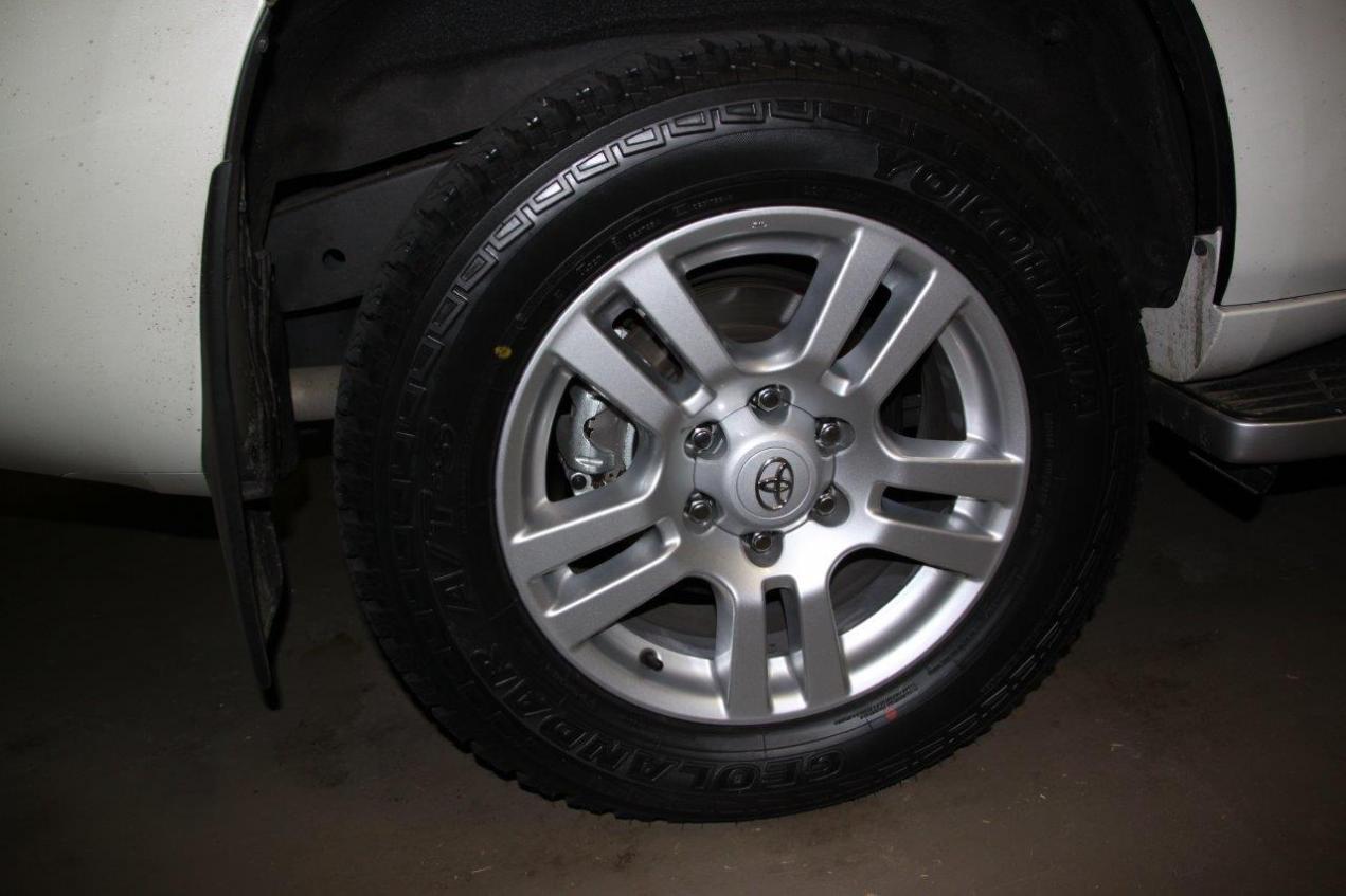

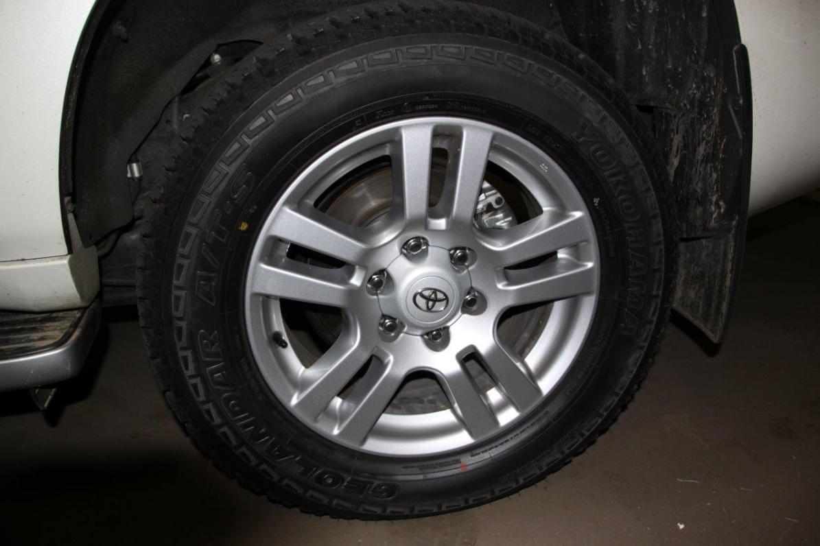

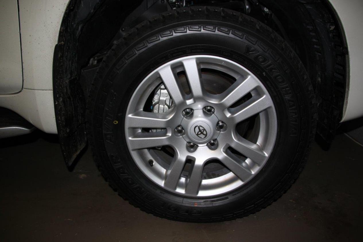

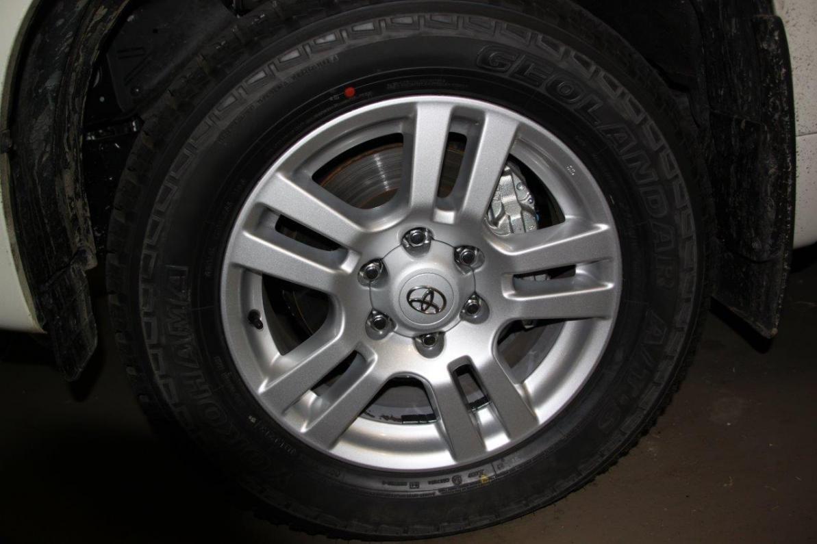

              Red and Yellow dot relative position to the tyre valves
              Hi amts, the photos below show the relationship of the red and yellow dots to the valve. BJ told me that the red generally is to line up with the valve, however they said they determine the best location during the match mounting process.

                I was talking about the rim as well.
                Hutch- Prado 2012 petrol with the TJM Catologue.
                [b]Rob[/b]
                  I agree with ####, sounds like run out issues on the rims or tyres.
                    Hmm, it's normally yellow to the valve stem and red to the mark on the rim showing the low point dimple/notch (usually for steelies). For alloys, the yellow dot should correspond to the valve stem. I could be wrong here but I'm no tyre fitter.
                    I also noticed that all (except for one where I can't see the weights) the weights are near the yellow dot. I think if BJ rotated the tyre with the yellow dot next to the valve stem, they would end up with a tyre that is easier to balance with less weights needed. This doesn't cure the out of round tyre issue, though.

                      amts, the rear drivers wheel appears to have no weights on it, unless I am blind. I will check that out with BJ.
