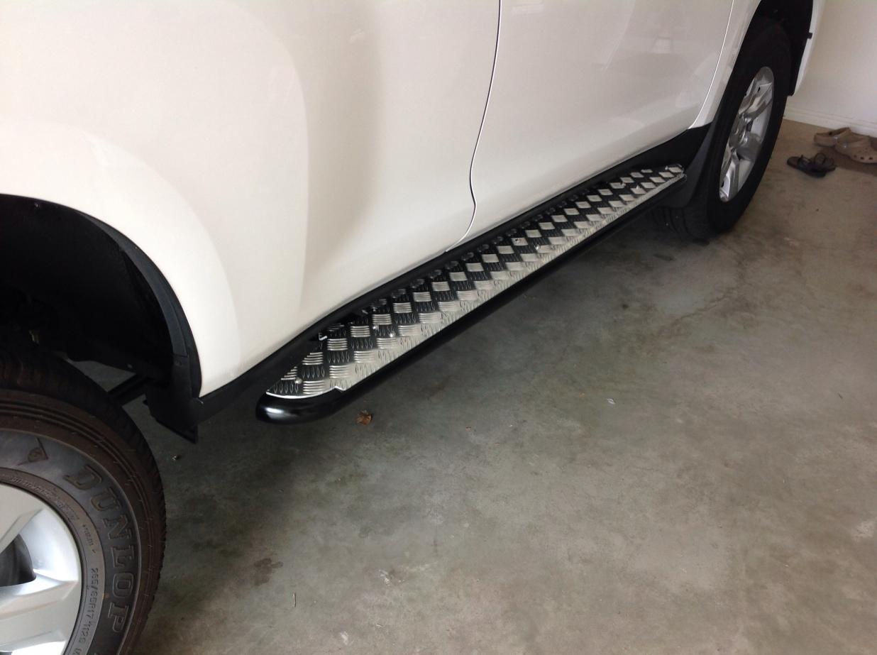

Picked up the prado from getting her 18 month service,always happy with Ashburton Tyre's & Automotive.Fitted so far:-Toyota Alloy bar,Redarc BDCD1220 battery managment system and dual power outlet,tracklander full length rack and ladder,Milford cargo barrier,Kaon transmission guard, UVP& Lower Shock mount Guards,Dobinson/Bilstein suspension,Toyota Bonnet and headlight guards,39ltr engel and an opposite lock stubby holder (from the old '80' series),Polyair Airbags,Pradopoint sticker,Gonefishin' custom Sidesteps.
