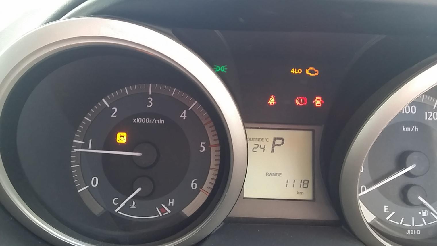

    Hi guys,
    I've just made the trek from Melbourne up to Cape York and am in a remote caravan park near Seisia. My friends 150 D4D Auto has sprung some engine lights:
    Flashing - 4LO
    Constant - Engine light
    Constant - Stability Control Light
    (See attached picture)
    My question is... Does anyone know what causes this combination or do I need to wander around the park looking for a scangauge, and is it safe to drive back to Melbourne.
    Thanks heaps for any light you can shed on this problem.
    Check the VSC sensor wires on the wheels
    [B]Steve[/B]
      Fixed! Thanks for that!
