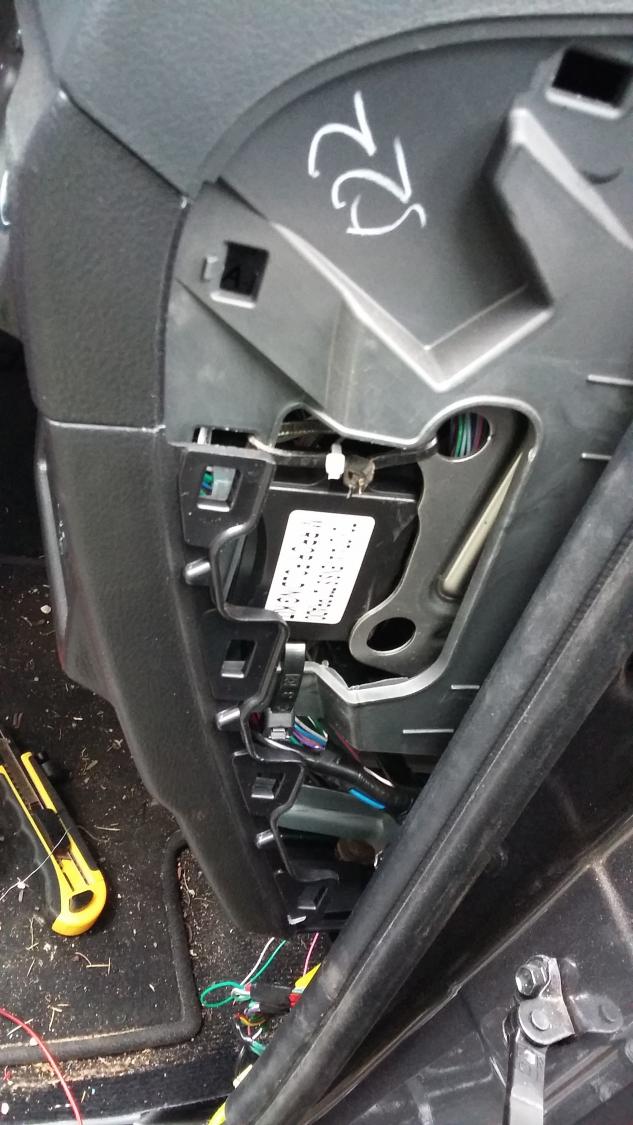

Did the install today. Works a treat.

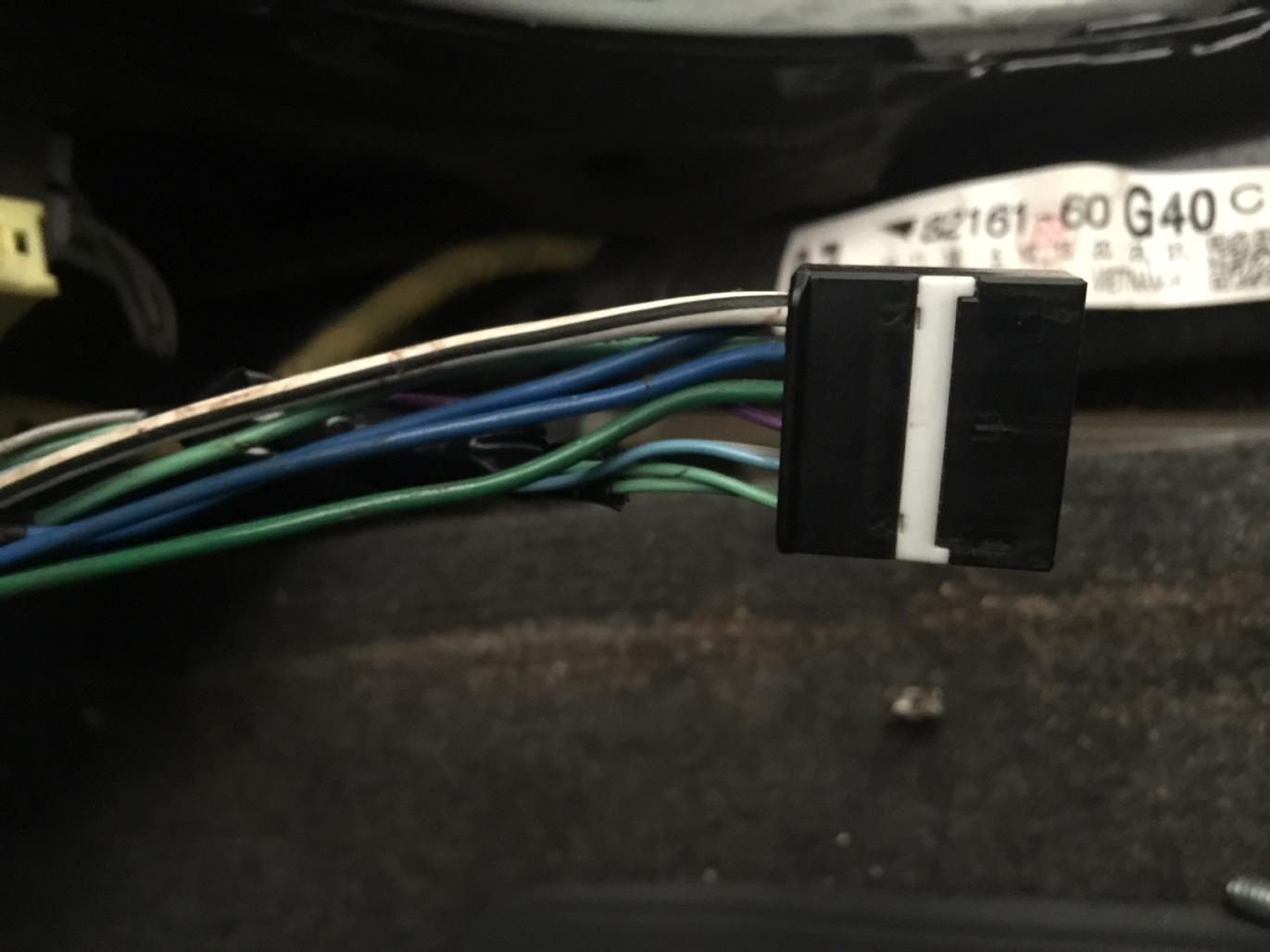

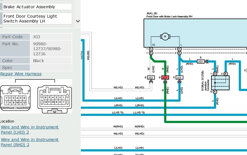

I too had a good read of the drawings to confirm what I was doing - somehow I missed Cortez's earlier post. Yep the large dark green and dark blue wires on the top black connector JG3 . Pins 8 and 9. They are next to the large white (black striped) ground wire on pin 7.

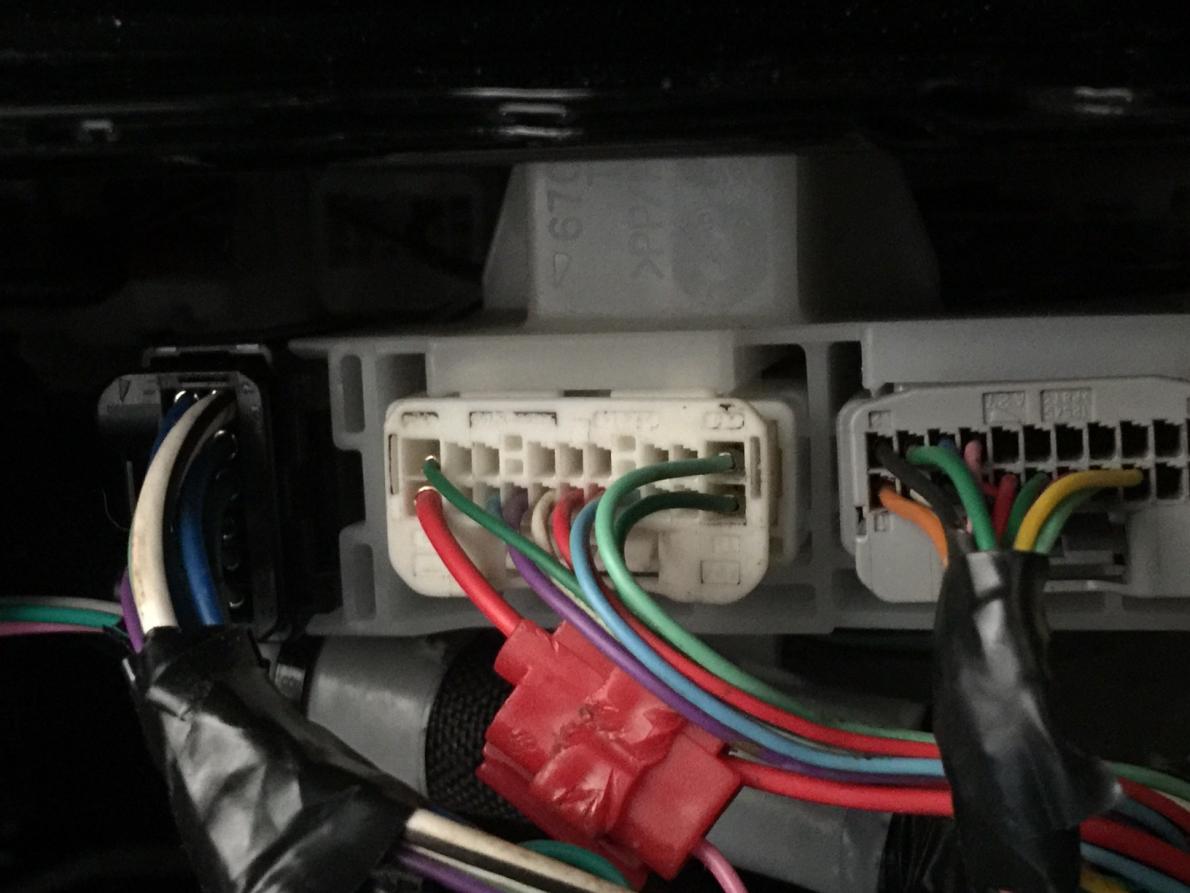

I used the large red wire on the white connector JG2 (pin 1) lower down for the +12v. Pink wire from folding module.
The grey UNLOCK wire from the folding module goes to that green wire on the black connector.
The green LOCK wire from the folding module goes to the Blue wire on the black connector.Last edited by MacroP; 22-10-2016, 04:36 PM.

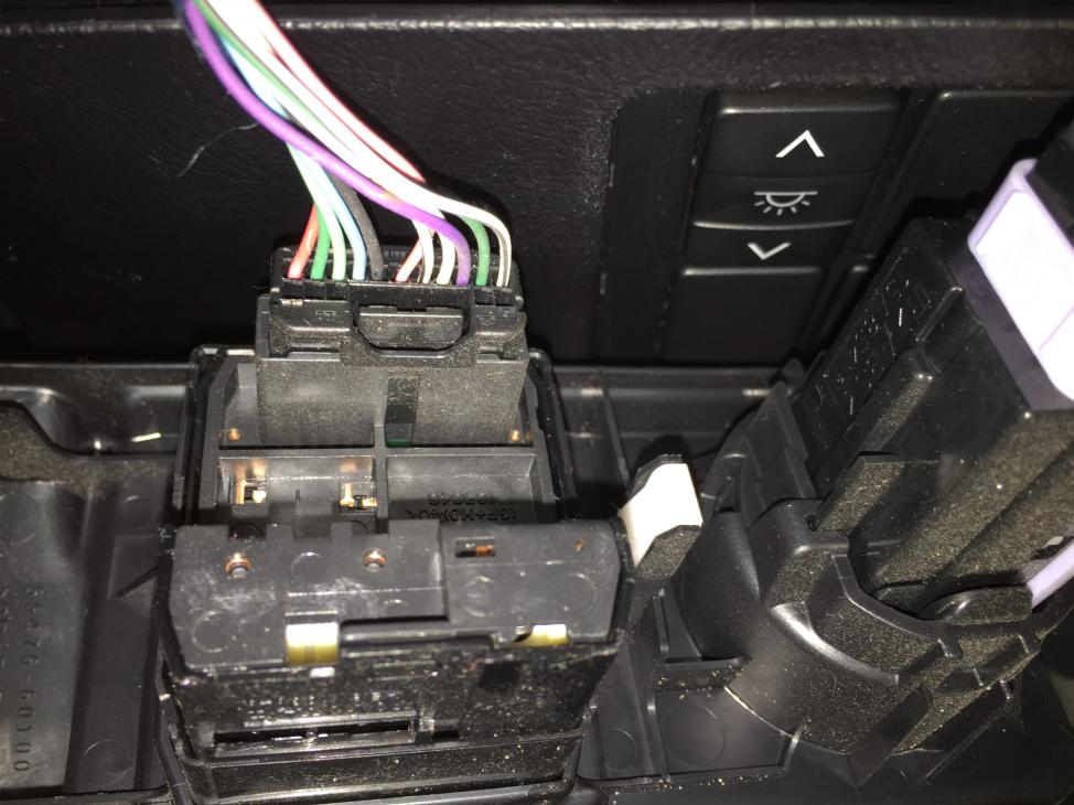

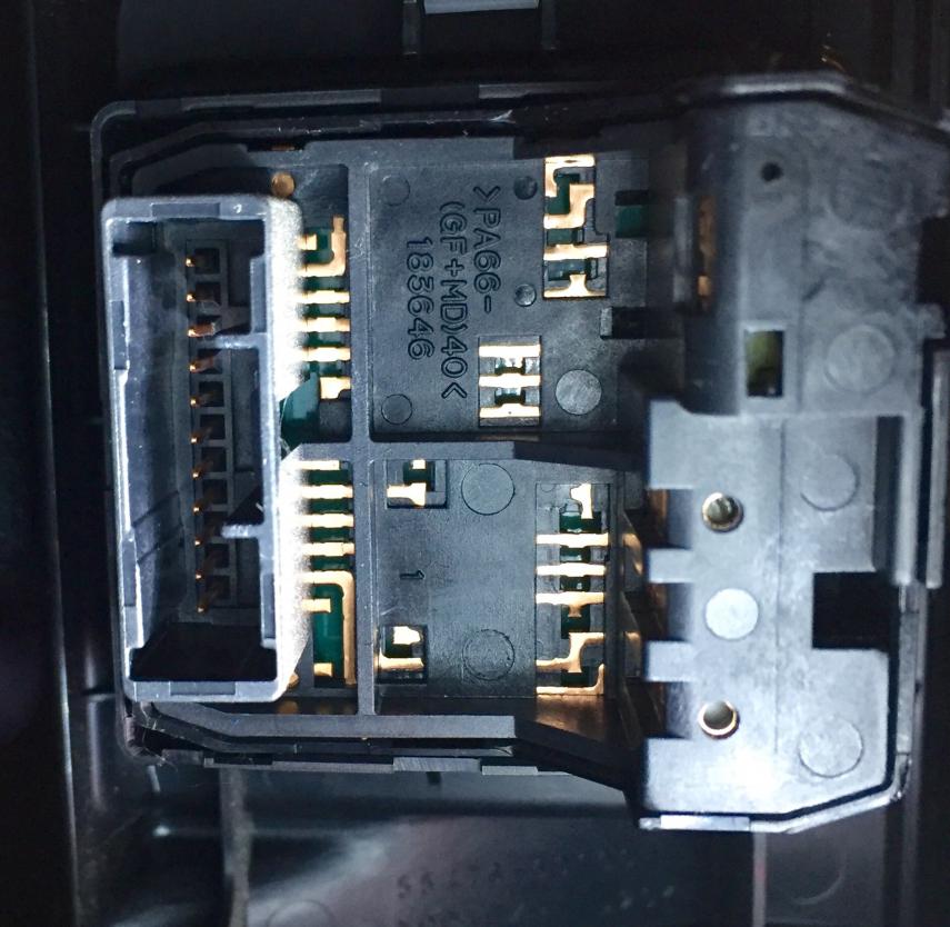

This locks doors, folds mirrors and closes windows. Th Aliexpress guys ask for picture of the back of the folding mirror switch. This is a hassle.....I may take a gamble on $50 and buy it..Regards SAFTGT
