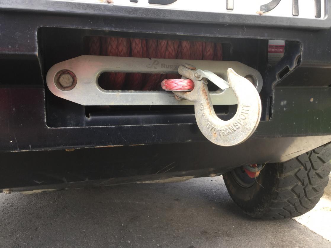

                    I have just taken a photo of my ARB bar.
                    It appears as though the holes are more central to the Throat of the bar, so I think the Standard Hawse will be ok.
                      With the standard Fairlead being OK with the Runva fitted up to my Sahara Bar, I just wasnt happy with the final look so I ended up shelling out for an Offset jobbie which fills the hole better.
                      With Offset Hawse Fairlead...
                        Ok, I see your point. Your rig looks good.
                        I also just found this thread... Which took some finding.
                        http://www.pradopoint.com/showthread...or-ARB-bullbar
                        It basically says that a standard Hawse will be ok, as will an offset.
