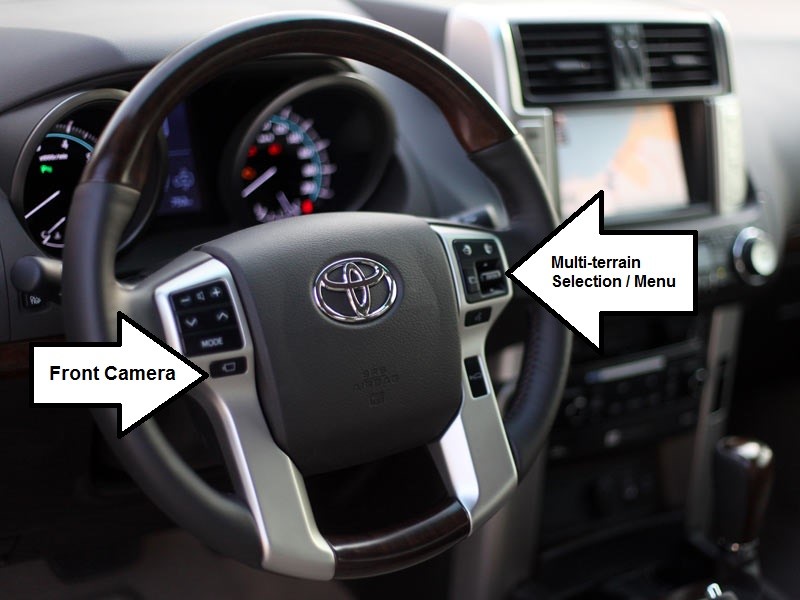

    Hi Everyone, My prado 2010 vx-l suddenly steering wheel front camera button and multi-terrain selection and menu button stop working, while other all steering button functions ok. Please anyone can help to solve it....
    I need this to be fix on highly urgent basis since I lose all Menu front the screen to handle the cruise and all important features,
    My local Toyota Vendor in (Kingdom of Bahrain) don't understand the issue and no alternate to fix it here.
    Please see the attached for more clarification !!!!!!!!!!!!!!!!! and thanks in advance to everyone.
