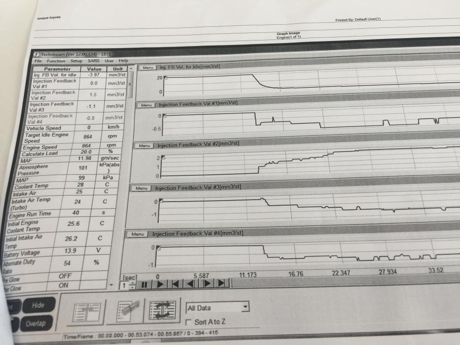

    These are the feed back values that I received for our 2012 Prado 150 with 112000km on the clock after a visit to Toyota yesterday, they recon everything is within spec could some of the expert on the forum take a look and tell me if this is the case.
    I believe you may need the engine diagnostic analysis done both cold (as this analysis is) but also at full engine operating temperature as well, but others will be able to comment with more authority.
      Yeah that's a snippet of a diagnostic.
      Definitely need a shot at full operating temp.
      Then you will have a quarter of a diagnostic.
      Half an idea can be obtained if you supply the 5 shots with all info as requested in another thread.
      That shot does not even show the injection volume.
