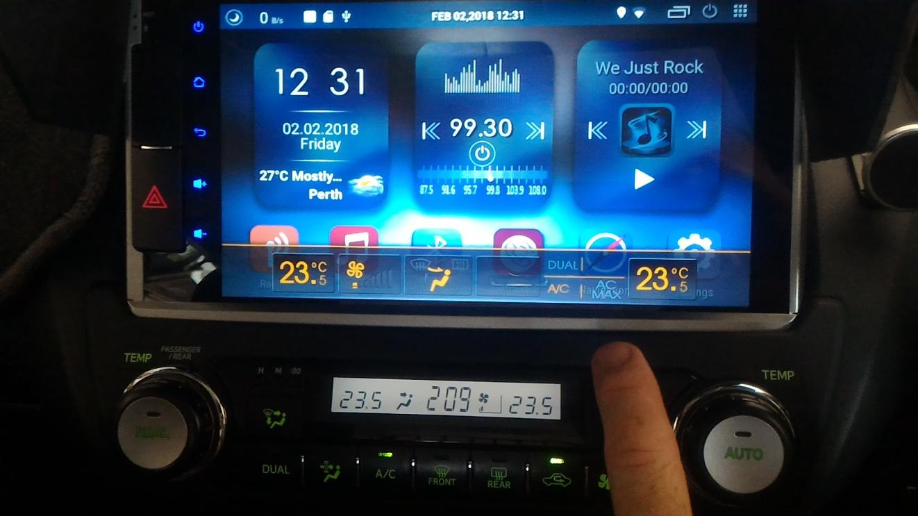

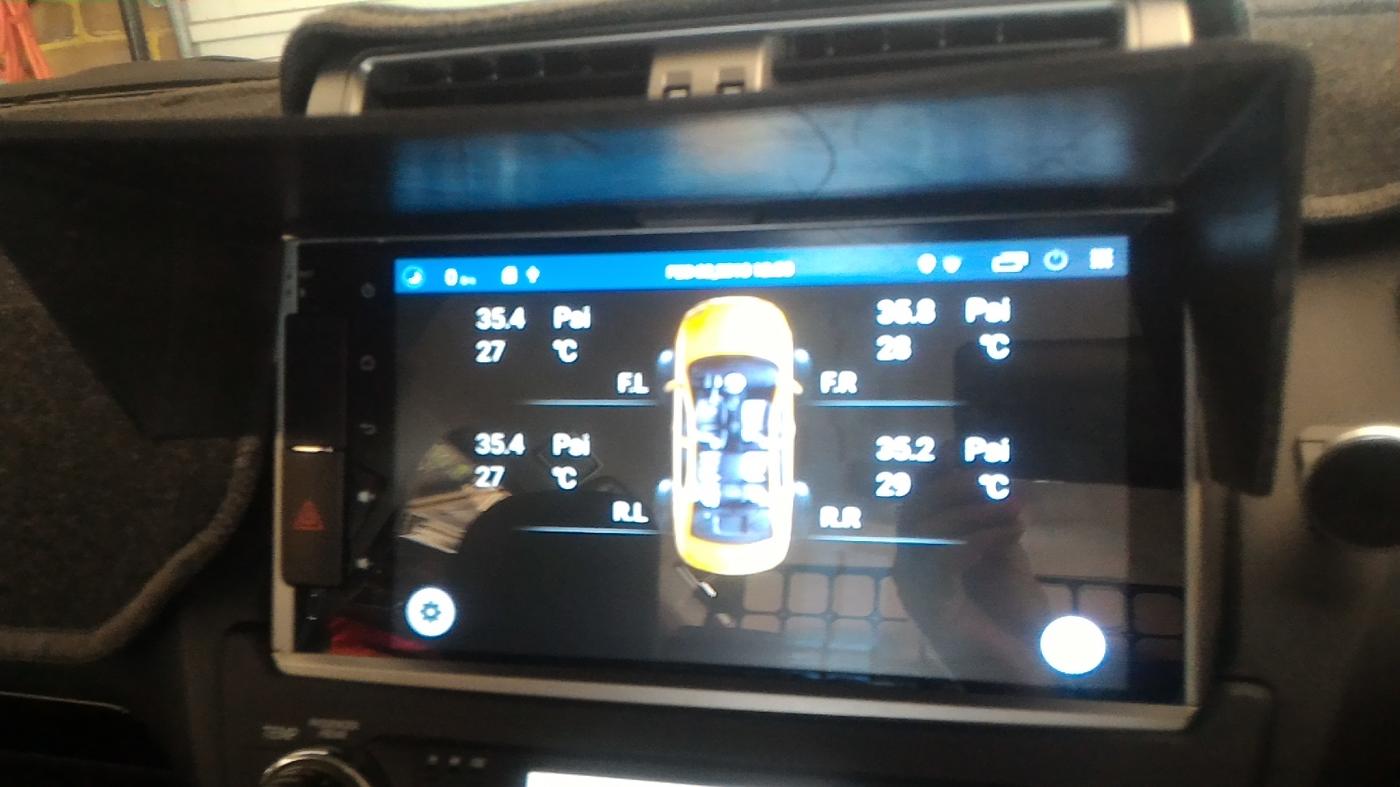

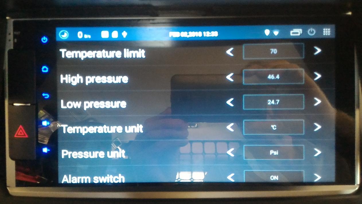

            Installed the TPMS add on today. Used the external sensors and they are pretty accurate (measured off two separate gauges). Has settings for high and low pressure and temperature. Cost was $75us. Also, from the latest ROM and Malaysk's ROM, I get a 5 second display of the air con settings when I press one of the buttons. Must be talking to the CANBUS.

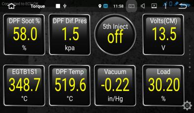

              After much struggling with a camera worrying that I would show my ugly mug in the reflection I finally worked out how to take a screen-shot Paddy. So I have attached this one just to show off!

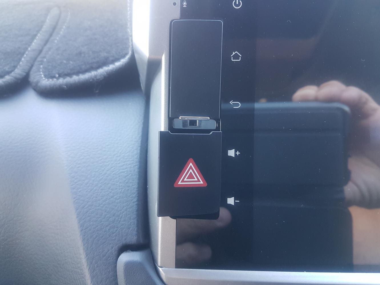

Name:	hazard button.jpg
                  this is mine.
                  • #54
                    Yes Ciaran, the hazard button came with the unit. I had to unclip the wire connection from the back of the original one and re-route the cable to the left hand side. It just fits as John has previously mentioned. These units are designed for the European market, hence the hazard button being on the left hand side, closest to the driver. Have you sorted the door open indicator and updated to the latest ROM. Just checked and the latest ROM is from the 1st of this month and the latest MCU is V2.75 (MTCE), both can be downloaded from here:

                      Thanks paddyb
                      I thought this was the case. Unfortunately I received no button with the unit so I emailed Aliexpress and got a reply From a Danny Zhu saying that the button was not included with the purchase. He seemed to think that the original button fitted into the new unit. So sent some pics and some dimensions of the original button to show that there was no way that button was going to fit into the new unit.
                      Just wanted to make sure that the button is supposed to come with the unit.
                      seems I ve got a bit of a "rocky road" ahead. Hope I can sort it out.
