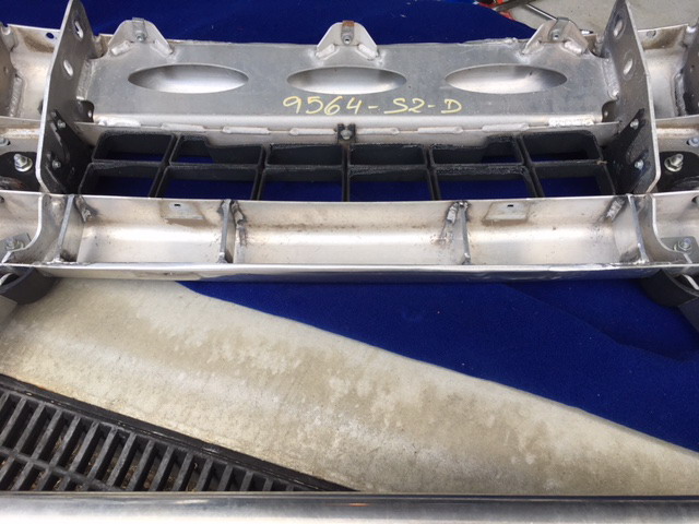

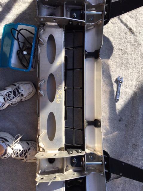

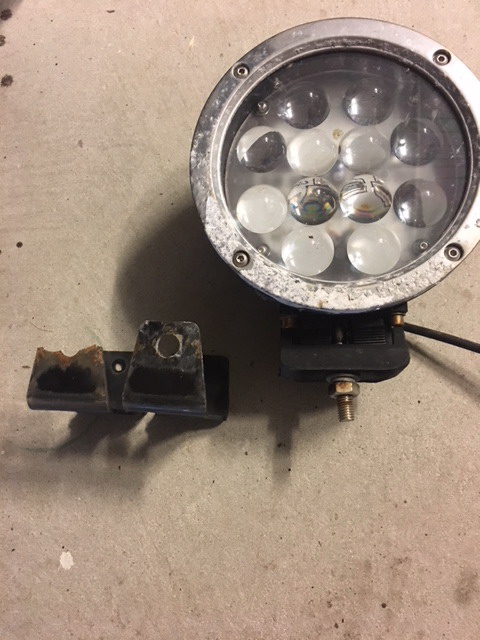

    The Toyota Alloy Bullbar on my 150 has broken at the spot light mounting points. All that holds the spotlights in place ATM is the flimsy steel bracket under the alloy (as the alloy is cracked all around the LED spotlights base).
    I noticed it when I was looking for a rattle as the spot light now make a quite a noise.
    The Bullbar was damaged on a recent trip due to really bad corrugations.

        Yowie, the Prado is an early 2013 model (pre-facelift). The spot light just broke away from the Bullbar (due to travelling on a badly corrugated road) breaking a piece out of the the alloy cross bar and flimsy steel bracket under the cross bar. I have since repaired the Bullbar and had it strengthen with a piece of 6mm bar welded underneath the cross member with some gussets to ensure it wont break again. I am also fitting a spotlights with bigger mounting feet. See the attached pictures.
