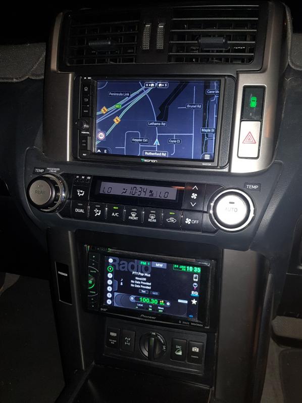

                Hey Krytox, love that in dash setup- Have you got a build thread I can look at, pretty interested to see what you've done with those headunits.
                  no build thread.. but i did make a tutorial in the accesories page.. with our current setup i have a pioneer for the main radio.. Bluetooth and steering controls. the upper unit i have connected for gps and internet. since ive changed the lower left switch to a gps one... and that triggers 2 relays to toggle speakers between the two head units. I'll work on doing a write up in the near future.
                    Looks good mate, keen to see and read about it.
                      link please.. looks great. im in ringwood. how do i get in touch
