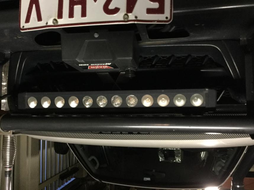

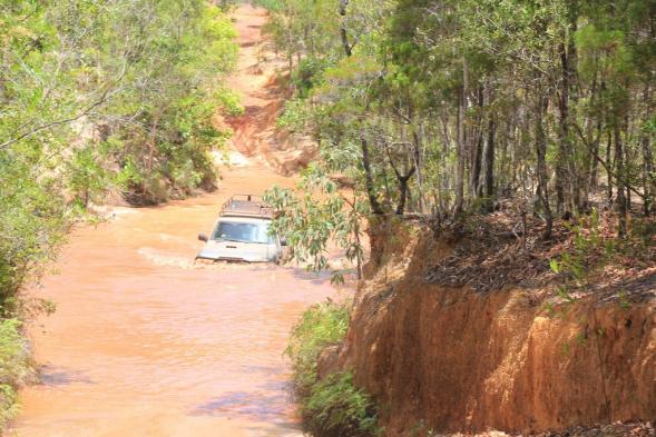

      Iíve have this light bar from Stedi lights since 2014/15 on the old girl and theyíve been underwater crossing the creek between Fruit Bat Falls & Elliott falls see pic (not my vehicle but same crossing) and not a drop of water. They have a constant spread of light between the flood and spot. Theyíve been used at night when itís raining all good . no condensation at all.. Really happy with them... no idea why there upside down. Ps no affiliation with this mob!

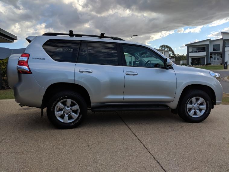

                  Sorry, meant to add these into previous post- Shows the difference between the right gear and wrong though. (plus one stock to give reference)
                    Ive seen those pics in diffefent thread, and i see what you mean
                      Atherton, the second pic. Is that the correct set up, as the prados are suppose to sit slightly higher in the rear i believe i read here
                        I was just re reading this as i was going through the unsealed 4x4 mags and did notice in the test, that condensation had built up from just leaving them outside and water inside from submerging.
                        are your still going strong.
                        maybe they just got a dud light or they made your properly.
                        others have mentioned stedi brand and like them. Price is good for me to
                          I'm over buying cheap stuff. I've done half half on my previous two cars and it's a pain in the arse with the cheap stuff always failing or not meeting expectations.
                          Get decent brands of everything. You won't regret it.
                          The cheap brand lights for example don't put out anywhere near as much light nor as good a spread when compared to the good ones. Guarantee they'll say they're as good but if you see them side by side there's no comparison. Cheap ones usually fog up and are more likely to fill with water.
                          I've got cheapos on my car at the moment (courtesy of last owner) and will upgrade to Stedi's shortly.
                            Yep, they're supposed to sit "arse up".
