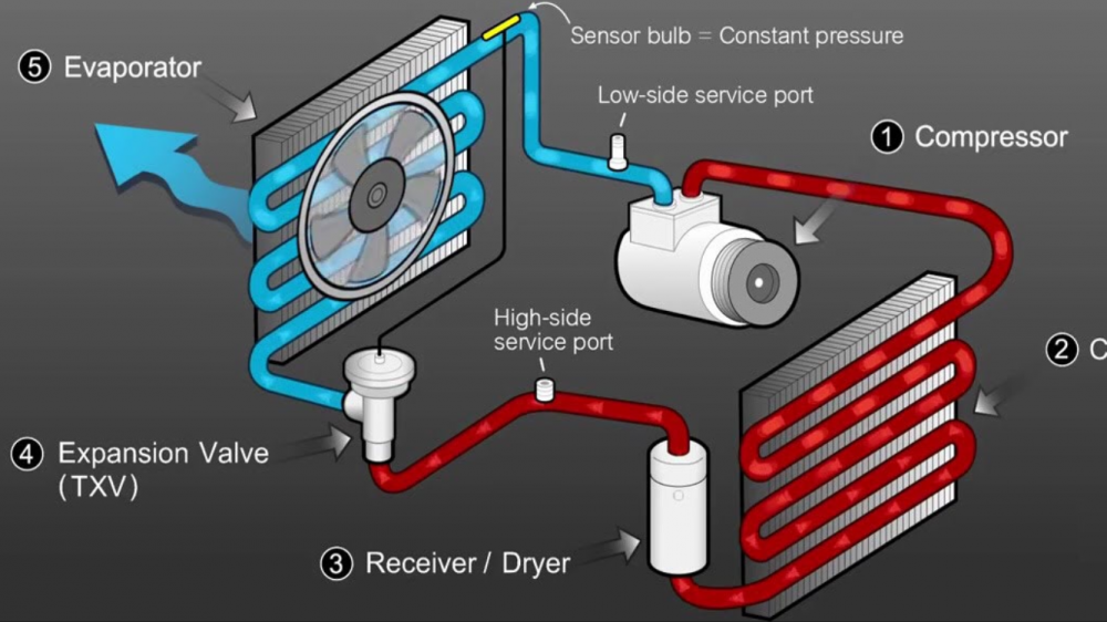

          Found a nice pic of the AC system which may help a few other AC novices like myself
