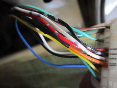

        I have a similar problem with my reverse camera in my 2012 GXL - quite grainy. However, my 4 pin plug wires at the camera are different??? Red, black, brown and white (no yellow in site) Have purchased a replacement camera and am having difficulty getting it to work. The red and black presumably are straight forward as + and - but not sure about the brown and white. The aftermarket camera comes with a yellow video plug and the extension cable that comes with it has 3 wires, yellow, black and red. I thought perhaps that the 'brown' on the Toyota plug might be the video feed but no luck. Have you had any success changing your camera?

          I have successfully wired a 3-wire camera that I mounted on my camper trailer to my Jan-2017 150-series Prado. It works really well. The wire colours are not what you'd expect.
          Firstly, the OEM camera operates on 6 volts. Do not connect 12 volts to it!
          For the 150-series camera circuit:
          Code:
          Black or Black with Silver stripes: +6v OEM camera supply
           Red  or  Red  with Silver stripes: Video+ (video live)
          White or White with Silver stripes: Video- (video return)
                 Grey,  Orange   or   shield: 0v (-ve) camera supply/Ground/(electrical noise shield)
          Connect the camera's -ve supply wire (usually black) to the Prado's 0v wire AND the Prado's white wire (Video-)
          Connect the camera's video output wire (usually is wired into a yellow RCA line socket's central pin)
          Connect the camera's 12v supply wire (usually red) to a 12v source in the Prado (you can use the reverse light wire for reversing cameras or Accessory wire from a rear cigar socket)
          RQ1 plug on a 150 series (this is located just above the floor in the driver's side rear pillar):
Name:	RQ1 Plug Camera Wires MedRes.jpg
          Edit: Oops. I thought the 2012 was a 120 series. I now see it is one of the earlier 150 series and I have corrected the text, above.
