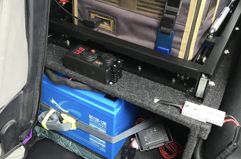

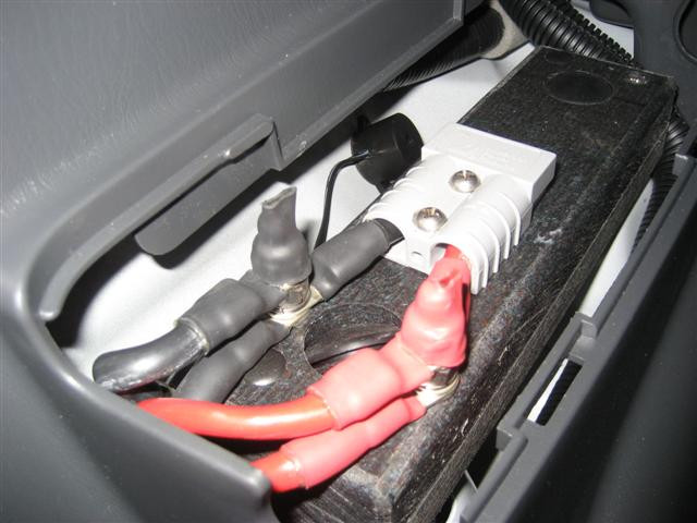

      I did this and photos of solar installation cable came down through rear taillight. Also connected to cable coming from alternator as shown using anderson plug and then to second Battery secured right behind 2nd row seat with CF50 Waeco, on slide in front of it

        looks like the best way to bet the power inside. I have the second battery behind the rear seat in a “drifta” drawer cavity with alternator feed.

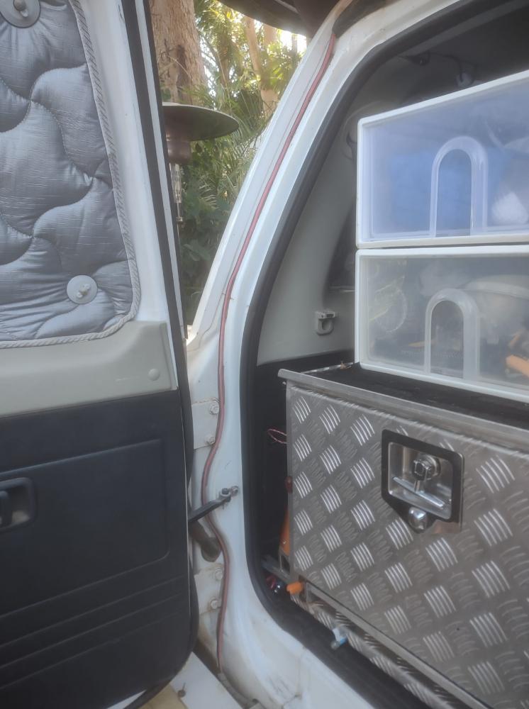

              This is a photo I saw recently on another forum. It's not a Prado but the concept should work on a Prado.
              The cable uses the tailgate void just outside the door seal - the cable does not cross the door's rubber seal. After cleaning the track of the cable thoroughly, the owner used double-sided mounting tape to secure the cable to the bodywork. The cable enters the body through a grommet (sealed with a silicone sealant) or a cable gland underneath the car, so the entry hole is concealed.
              Click image for larger version  Name:	Vehicle Roof Solar Wiring.jpg Views:	0 Size:	78.1 KB ID:	770112

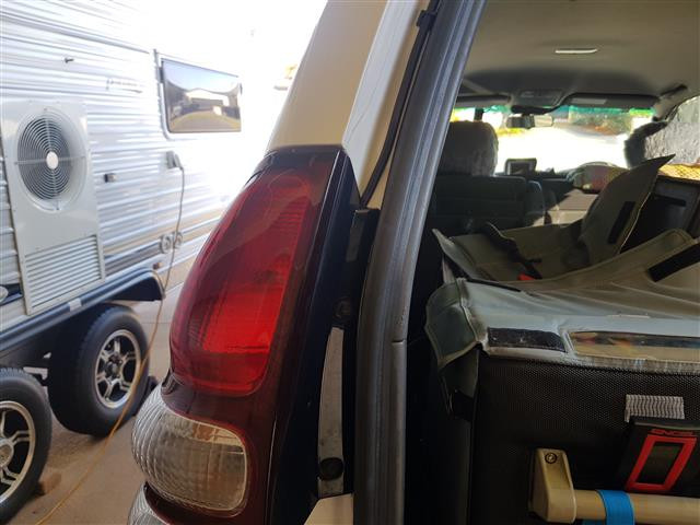

                This is how I did our 120. down outside the door seal and then drill a hole in underside of the tail light. That lets the cable into the inner guard area.
