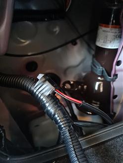

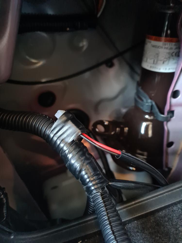

    Hi guys, What is this plug behind the left rear tail light for in a 150 series Click image for larger version
    Not standard. Looks like a feed from the battery. Have a look around the battery.
      I just picked up a new GXL and have the same plug, nothing I ordered and the sales person has no clue!
        I have the same plug in a new GXL
          Does it have power on it??
            Either of you have the Towbar? I know that the tow bar wiring is all around that left hand corner when they install it. If you have the tower, perhaps that plug is used...
            Just a guess
            Ant
              I have a towbar fitted with a 12 pin plug and this wiring/plug is spliced off this. Maybe a power source for fridge
              Stu
                I have tow bar installed
                  I had a towbar fitted, the wires to this plug feel like they go upwards.
                  thx for the replies..
                    i guess is for power bulb cable replace the reflector at lower rear bumper, can you check righ hand side does have same connector
                      It's gonna be a feed for a rear fog lamp.
                      It will only be on the left hand side (assuming you have a right hand drive) as you only have a single rear fog light.
                      Annoyingly when I imported my Prado to the UK the mechanic installed a new fog light on the right hand side, stealing power from my light dipping motor. Little did they know that there was already power on the left.
                      Snodlander
                      Lurker
                        I finally got around to testing this plug & it goes active with the reversing lights....
                          Interesting. Another reversing light?
