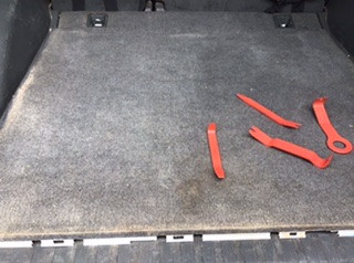

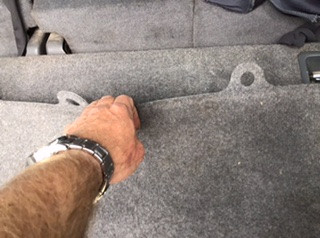

    To start removing carpet lift up slanted panel at back of seats and unloose carpet loops from small plastic rods. Only got to lift panel about 1cm up to un loop carpet.

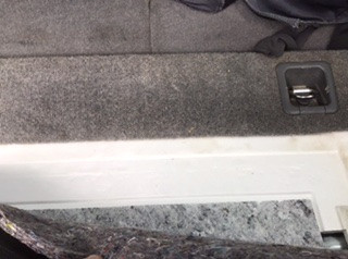

    Then you can carefully pull carpet away from side panels all the way down to rear of the cargo bay. Carpet at rear trim you can access clips to disconnect just need something to push clip down while pulling carpet towards rear.

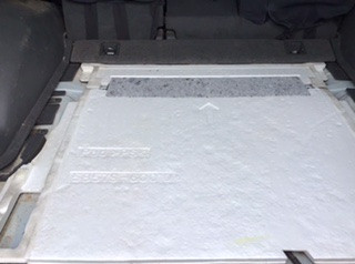

    Floor of 5 seat prado there aren’t really any predrilled holes for installing rear drawers?
    Any suggestions?
      Hi
      Still going on prefab drawer install. Had to remove attachment cross member frames, next set of holes on frame closer to rear door on both to be able to drill bolt holes into floor. Been quite time consuming lining it all up. Hopefully this helps others.
