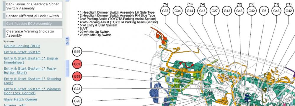

    I live in remote wa and have lost my only fob key. Can anyone please tell me where is the smart key ecu located as I need to remove it so it can be sent off for reprogramming for a new key. I have googled it and can not find any info on location for 2010 prado
    Plenty on goole or try partouq, amayama for the diagrams.. Down in under dash but next to the centre console, usually on Driver side.
      This diagram suggests the "Entry and Start System ECU" is located to the left of the centre console. Diagram is for RHD, 1KD-FTV ("Certification ECU Assembly" Selected).
