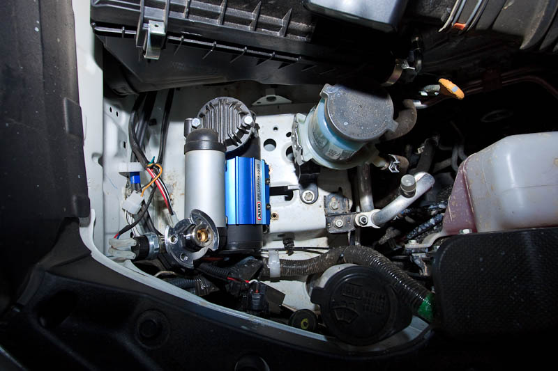

      I have mine mounted on the drivers side at the front, where it looks like you might be able to fit a second battery if it wasn't for the power steering reservoir being there.
      I'll take a photo...

        Ok, here's a very quick snap of how it's mounted.
        [attachment=0:its6y90u]AirCompressor-7006.jpg[/attachment:its6y90u]

              Eventually. There's another spot that may fit a battery (passenger side, rear).
              The spot where I've put the compressor is quite small, and would require moving that reservoir in order to fit a tiny battery in there. It'll be a bit of a way off before I look at a dual battery system anyway.
