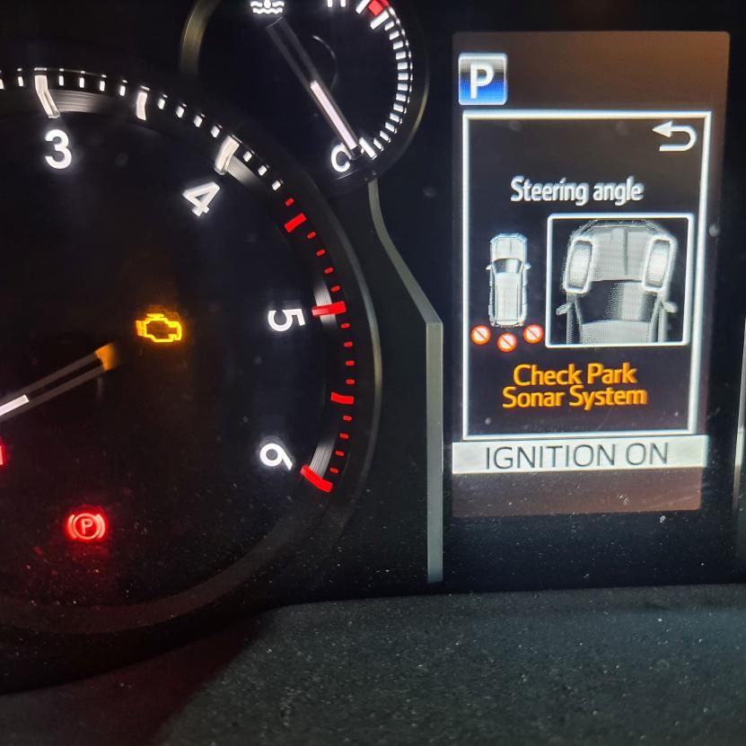

    Where do I start looking for the source of the Check Park Sonar System fault that comes up on the dash when I turn the reverse sensors on ? Click image for larger version

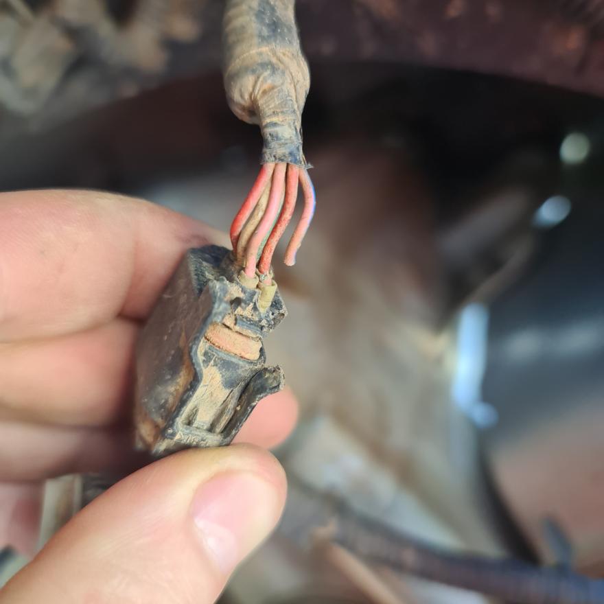

        Broken wire at sensor connector might be the culprit
          Yep that will be it
