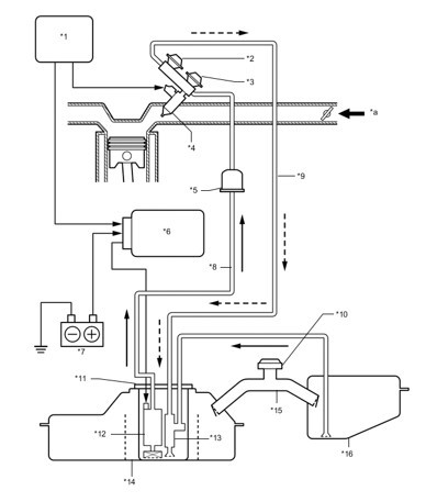

I need some thoughts on how to plumb it all in,
I believe the single tank of the GX460 will be similar to the single tank of the 150 series, and it has 1 port missing, and the fuel pump housing doesnt have the little venturi pump that transfers fuel from the sub-tank to the main tank. In order for this to work with the factory hoses, I would need to buy a main tank from a prado with the extra port, which probably is the return line, and the correct fuel pump cradle with the venturi pump, which would be added cost, which would be option b.
Alternatively, as a company in the US makes sub-tanks for the gx460, use an external fuel pump to transfer from their pump to the filler hose, the port to the transfer is plumbed into the filller hose past the sub-tank y junction, the pump is activated with button placed on the dash. This seems to be an easier method.
The prado 150 series sub tank has 3 fuel ports, feed, return and evap connection, and it has a 3 wire fuel level sender. I am going to forget about the fuel level sender, as that would be too much work, and use the 3 lines, evap I will "T" in with the main tank evap line, the main feed line from subtank via a external fuel pump to the filler hose, but the return line on the sub-tank not sure where to plumb that in with a "T"
