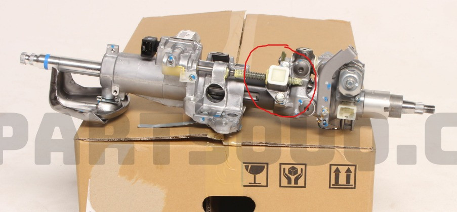

    Click image for larger version  Name:	Steering.jpg Views:	0 Size:	85.3 KB ID:	770064
    Sounds like the worm drive for telescope has stripped.
    Could be the fixed nut section in red but this is not available as a standalone part from what I can find in the Parts Catalogues.
    Part Number for complete assembly in picture is 45810-60041 GEAR ASSY, TILT STEERING, W/MOTOR
