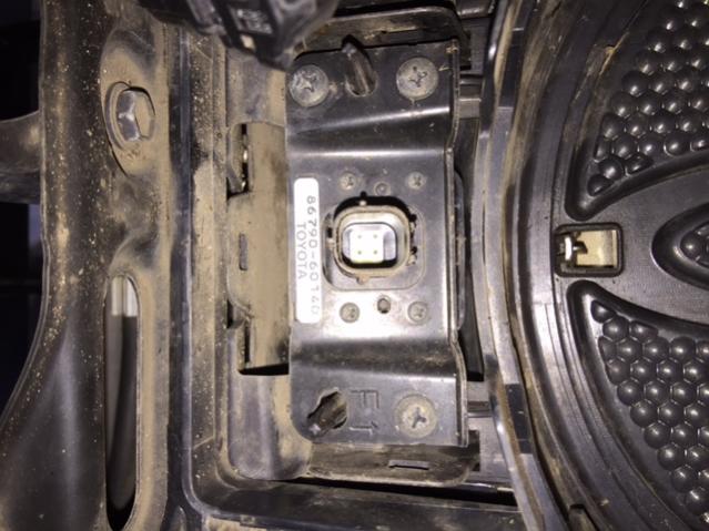

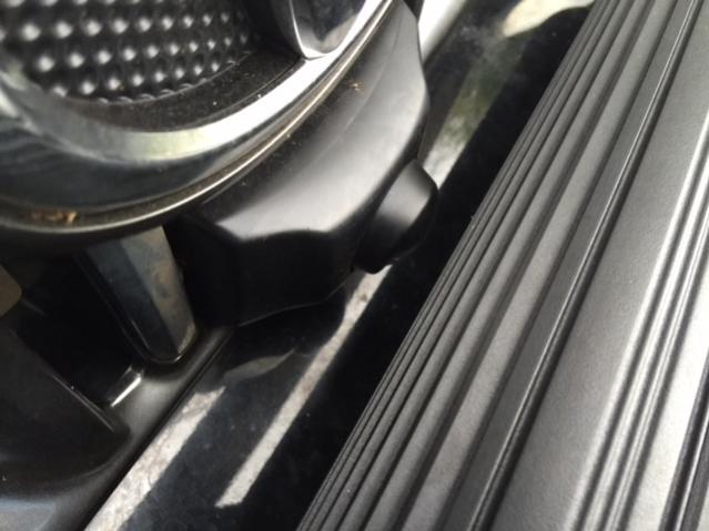

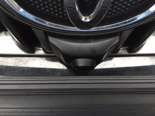

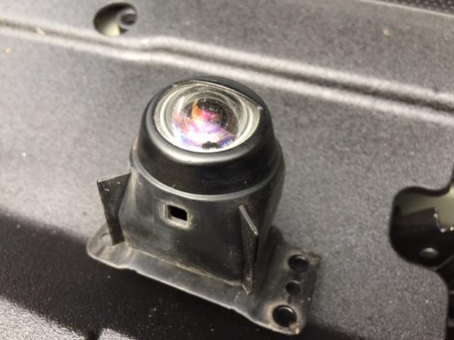

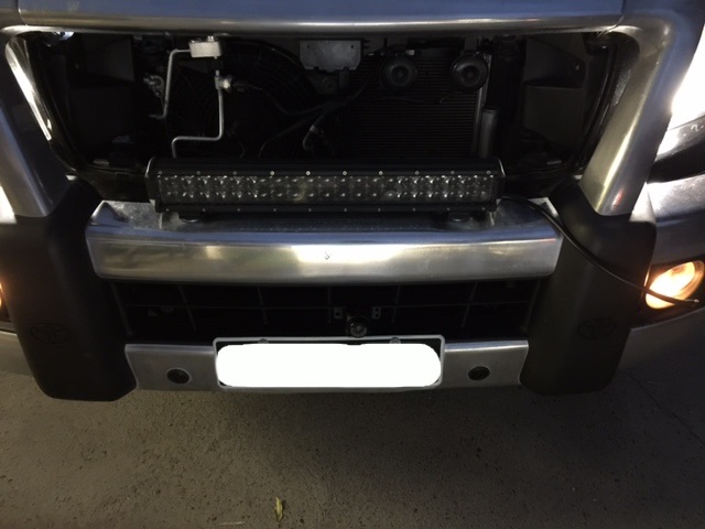

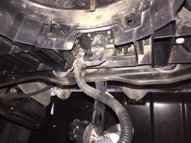

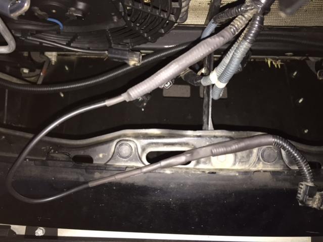

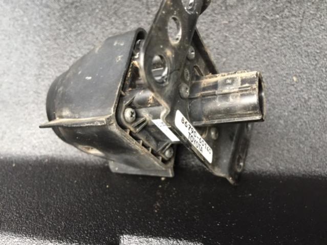

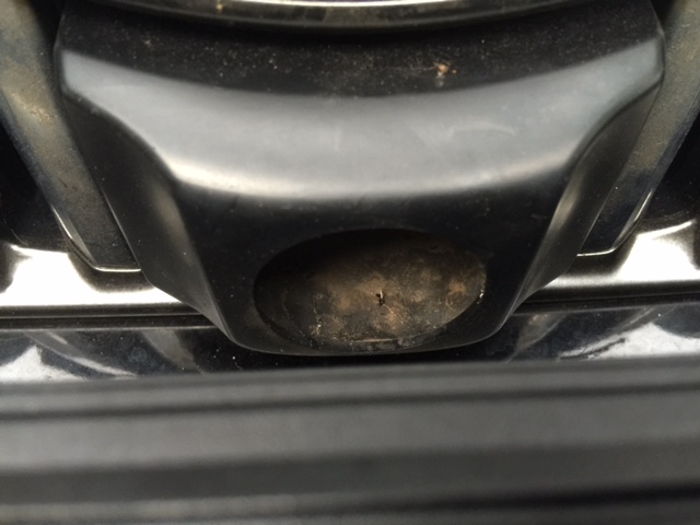

                      Hi All,

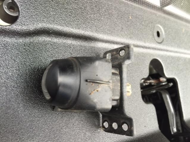

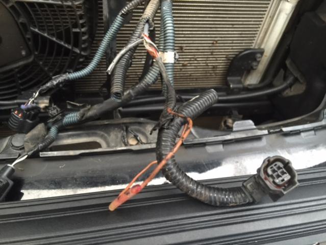

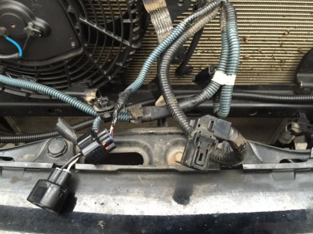

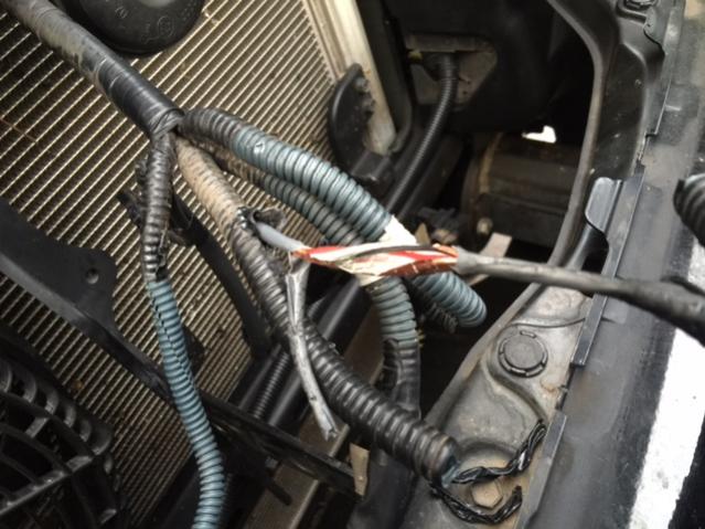

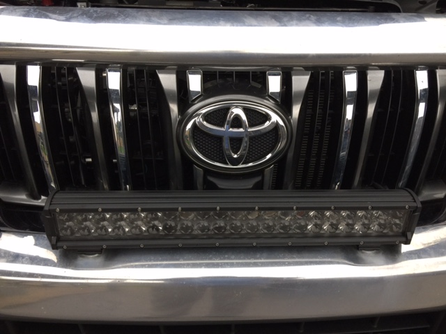

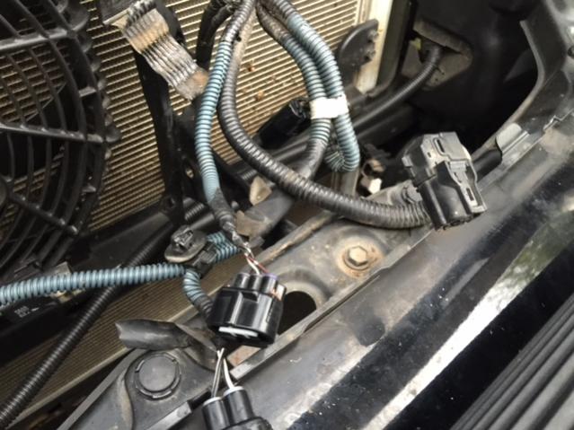

                      Sorry to dig up an old thread but this one is the most appropriate. I recently began my Kakadu's front camera relocation. Took me an hour or two. I have cut and extended (by around 30cm) the cable at the rear of the camera. I'll attach a heap of images which will easily tell the story. The camera is now sitting inside the front bar's grill - just above my number plate. From inside I can just see the (factory) bar uprights either side which means the field of view angle must be around 170+ degrees. Image quality is OK-ish and certainly better than looking at the back of my LED light bar.
                      May take a few posts to get all the pics uploaded.

                            So how did you extend the cable MacroP?
                              I just cut and spliced a very similar type of cable into it which I had in the shed. The original cable is screened too and has three other cores (red, black, white and the screen wire) - the screen wire has a copper cladding too. I just extended the cable using my soldering iron and some heatshrink. Came up looking OK.
                              I firstly removed the large plastic engine/radiator cover as well and the grill. Both come out very easily. This made for easy access to the camera's plug. The camera sits in a bracket which in turn is clipped into the grill. I clipped this bracket back into the grill once I had removed the camera.
