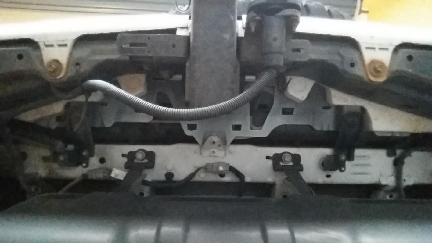

Just in case anyone was interested, the kaymar takes up a bit more room than the genuine tow bar, so room to fit a water tank here is reduced. Recon you might be able to easily get 20L in there, hardly worth the effort in my oppinion. Good to meet you though Tin175, hopefully we'll catch up again, I'm interested to see the next secret mod
[LEFT]Silver 150 Facelift
I didn't realize that HR went the Centre mount only route considering all the drama's with the 120 towbar. The receiver hitch sits further forward than the OEM bar and would need cut out section in the centre of the tank. Because there is no drawbar and side arms the tank can be wider which should mean a 30 or more litre tank should be possible. Is there anyone in the Brisbane are with a HR bar I can have a look at?Originally posted by andoland View PostTin175,
Here's a photo showing the hayman reece bar and you were right, it protrudes into the space a fair bit. Still, should be able to put an indent in the tank at this point. Photo taken on my phone so not the best quality.
[ATTACH=CONFIG]18956[/ATTACH]
