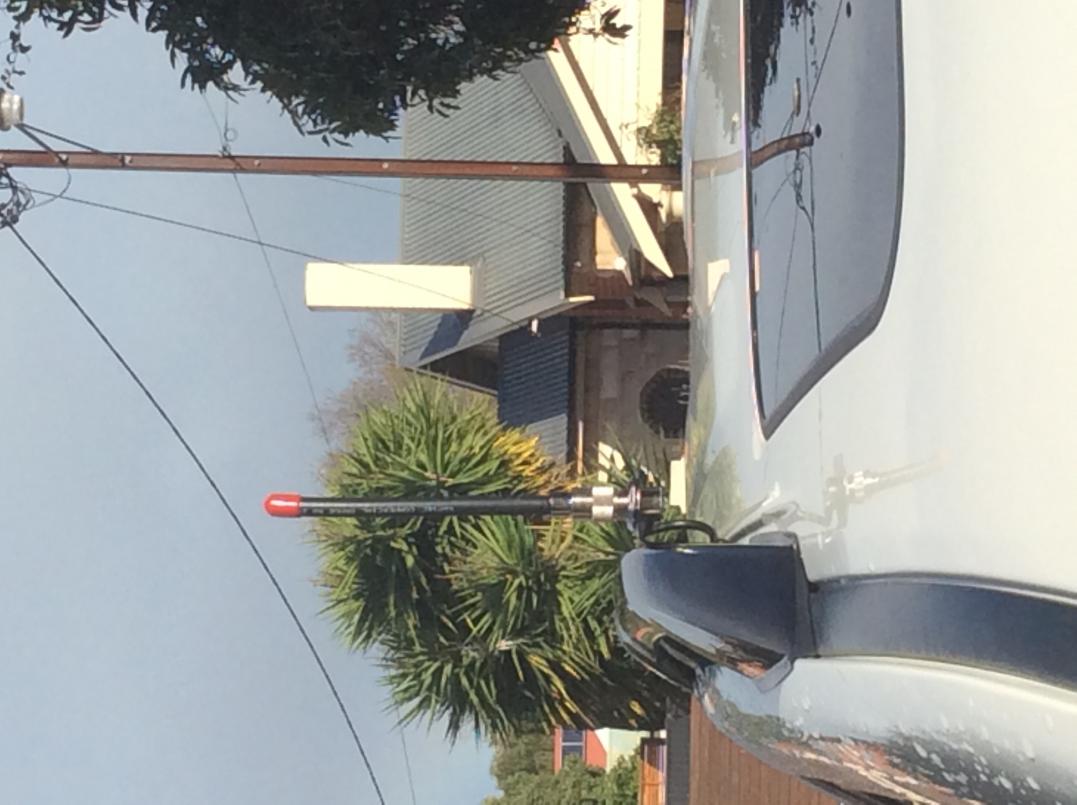

          My installation is taken from ideas on Pradopoint and using what I thought was the best and simplest approach for each issue. I have GME 3550s with remote handset that has speaker. Power from auxiliary battery through drivers side firewall(constant power, less interfence to signal), as well as antennae cable(stub antennae on drivers side roof rail, as installers said "height is might", don't need pole on bull bar, drivers side antenna install best location so is not affected by trees). Main unit installed in centre dash under radio (couldn't believe how easy it was to take the fascia off, installer showed me). Microphone connection velcroed to passenger side. Clic On fitting for microphones required no drilling. Chose passenger side because left driver side uncluttered for leg room, passenger not affected (wife most of time anyway & she has short legs). Easy to remove if I change vehicles, works great.

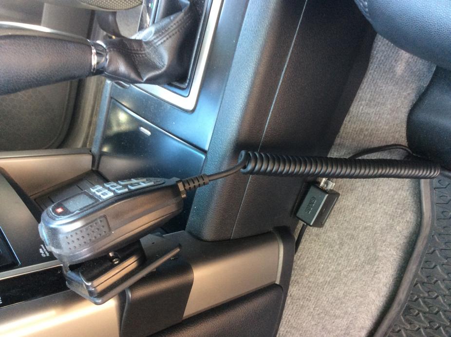

            I used the 'card holder' space, customised a switch blank and used a HoldMyPhone for the Mic (I have a Uniden equivalent). Power from the Cig lighter wire in the centre console.

              Do you find the UHF hand piece is bumping your leg there Bobcrusader?

                No, it's well out of the way.
