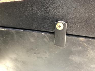

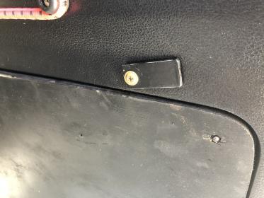

                  Hi, if you're still around, do you have any photos of your tray please?
                    Here is a few pics. Very simple and held it better in the rough stuff that the lacky's did.
                      Thanks, so you changed the design of how it holds up? what was wrong with the straps?
                        Because the table just uses the slots at the bottom, and not a hinge, and the lackys pulled upward, sometime over rough stuff the door would pop out and the lackys would pull it up and it would pop out of where it is suppose to be. These catches stop that.
