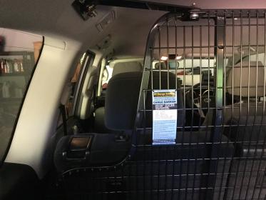

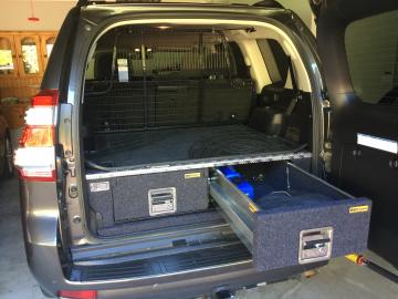

        Originally posted by mal58 View Post
        So the question then becomes is there a cargo barrier that meets the requirements for the 7 air bags, and can be used when the 3rd row seats have been removed
        The answer is yes. I had RV Storage Solutions drawers and cargo barrier installed in my 2015 GXL with the 3rd row seats removed. The cargo barrier has a gap at the “shoulders” to allow the air bags to deploy properly. Wasn’t cheap.Click image for larger version
