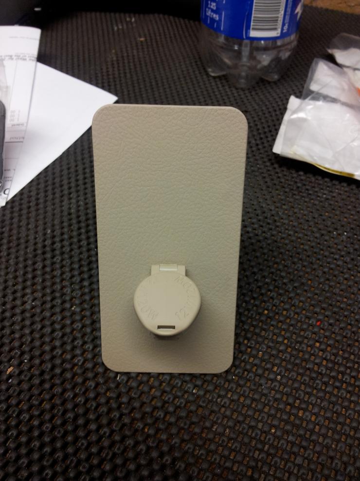

          Prado 150 - Toyota inverter conversion kit
          I presume everyone is aware that for those who would like a simple 12 volt socket in the back, in place of the 220 volt unit, Toyota sell the parts for A$121.00. The 12 volt parts replace the 220 volt panel and the 12 volt wiring is already in place behind the 220 volt socket, so it is plug and play. Therefore there is no need to remove the side trim panel, the changeover can be easily carried out by simply prising out the 220 volt panel.
          Obviously the 12 volt socket remains at 10 amps as per the factory wiring but this is ample if you just want to run a fridge more reliably. I have converetd my Kakadu and it works perfectly.
          The parts needed will come from Japan (mine took only two weeks) and are Bezel Part Number 8553660040A0, Power outlet cover Part Number 8553535080A0 and Socket Part Number 8553042010. These are the part numbers for the tan trim, the A becomes B in the first two items for the grey trim.
          Just thought I would note this in case anyone is not aware.
Name:	2012-02-25 11.08.00.jpg
