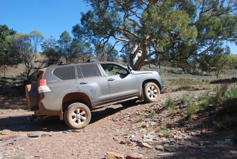

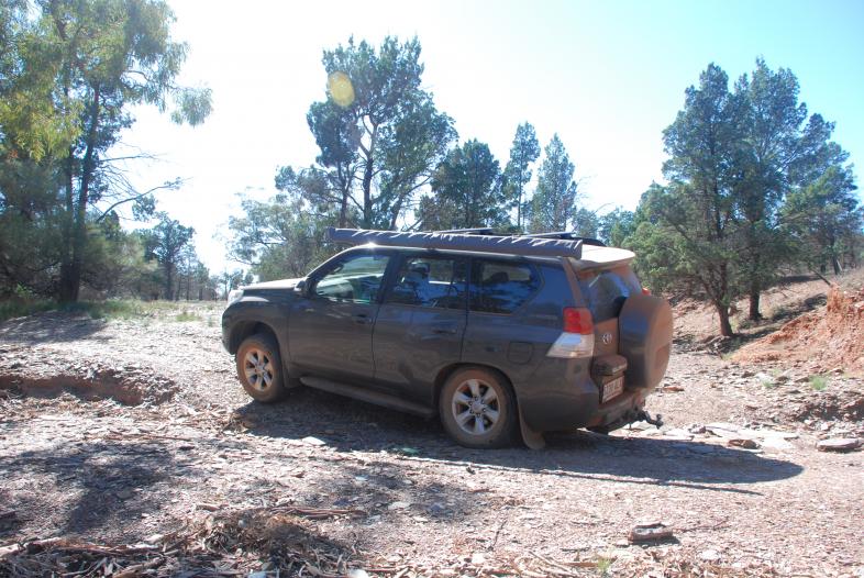

    Myself and the misses have a stock Prado 150 GXL (2011), couple of young kids and just upgraded to a Jayco Swan Outback (2012). I'm not a hardcore 4x4 guy but love to take the family to places like the Flinders Ranges (with the camper) and when with just the boys, Border Track, Loveday 4x4, etc for a bit of camping.
    What I've noticed when I've got the Swan hitched and the boot loaded with the usual camping and kid stuff is there is a fair bit of sag at the rear. I've been told that rear coil air bags will fix this issue and allow me to adjust the amount of lift via a standard quality air compressor.
    Questions i have and hoping anyone can assist with are;
    1. Has anyone installed Firestone or Pedders (Polyair??) coil air bags to their setup and if so,
    2. When unhitched from the camper and wanting to do some 4x4'ing, has anyone noticed any articulation degredation at the read?
    Longer term i'm planning to add a OME upgrade when i install a suitable bull bar BUT that's a few years away and ideally hoping to fix the sag and improve safety when towing without hindering off-road capabilities.
    Any thoughts/opinions/advice would be appreciated.
    Note - I've added a couple of pics of rear travel...car really amazes me and i don't want to loose the standard capabilities by adding the air bags.
